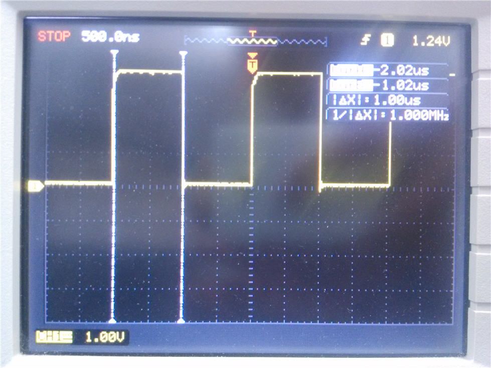

In Firmware we are allowing the clock running with 80MHz and we are using an external 8MHz crystal on our board.Still, we couldn't able to achieve the 1us delay. We have checked with the oscilloscope we are getting 1.5us delay instead of 1us delay.Kinetis Design Studio. https://community.nxp.com/community/kinetis?sr=search&searchId=394033e7-f38e-4253-8ab5-e964a2ccd7f8&...‌

The red LED can toggle every 1us, test the pit demo in SDK_2.2_FRDM-K64F. (...\SDK_2.2_FRDM-K64F\boards\frdmk64f\driver_examples\pit)
Would you please tell us how did you achieve the 1us delay? You can attach the project here.
