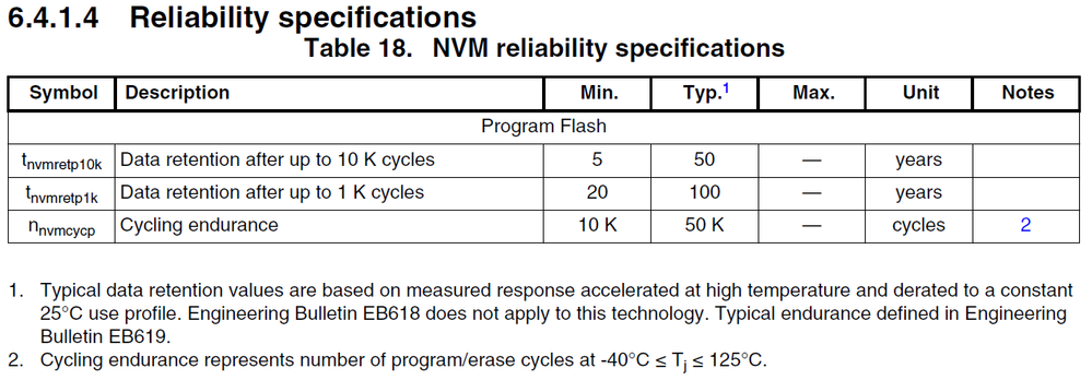

I'm using a MKL27Z256 and I'm using the internal flash to store device information that needs to be periodically updated.

Your part datasheet will have a section like this:
Unless those drivers do some kind of sophisticated 'wear leveling', these numbers will be representative.  As with all such nonvolatile memory cells, 'cycle life' depends on 'how many years afterwards' one needs to continue reading those writes (i.e., before time&temperature eke away the electrons).

Thanks but I already have the C90TFS Flash drivers implemented and I'm using the last two pages of RAM to do this. One page for logging system information and the other 1k page for saving system information. I would like to know how many times I can erase/write to these pages before they stop becoming reliable sources. I want to keep a count going so after a certain number of erases/writes I will migrate the information to another page.
Where can I find documentation about how many erase/write cycles I can perform on the internal flash before it starts to degrade? I am trying to estimate product life span under my current implementation.
