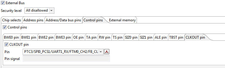

Then i went to CPU->External Bus -> Control Pins -> CLKOUT pin.
After enabling it and setting PTC3....

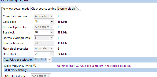

I went to Clock configurations -> system clocks tab.
And set the external clock prescaler to 1 and then the FB_CLKOUT was set to 48 Mhz.

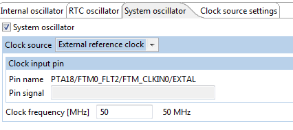

I have assigned the cpu component MK60DN512ZVLQ10.
In the processor expert I have my system Oscillator settings set to the following...

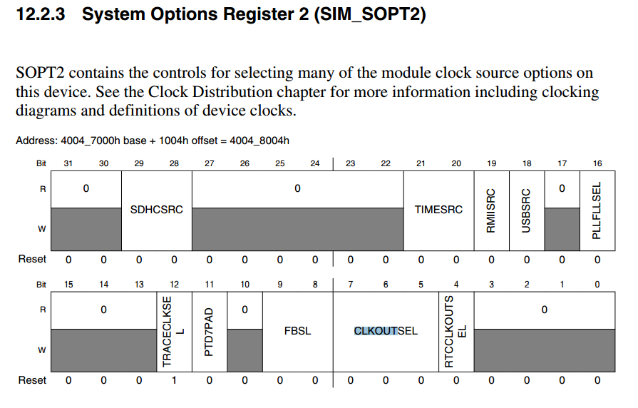

Next, you will need to which clock signal is sent to the CLKOUT pin. This can be done by modifying the CLKOUTSEL bits in the SIM_SOPT2 register:
I am using KSDK 2.0, and so I would set this bit like this if I wanted to select the OSCERCLK0:
SIM->SOPT2 |= 0x000000D0;
Once these bits get set, the signal should appear on PTC3.
