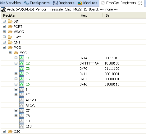

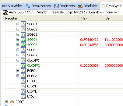

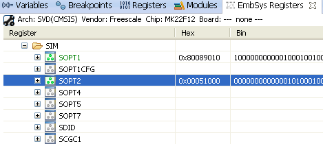

Hello, thanks for the response.
The 48MHz internal oscillator is not selected for the USB host demo for the MK22F120.
SIM_SOPT2 shows the USB Clock source is going to come from MCGPLLCLK, and likewise the PLL is the MCGPLLCLK clocking source.
MCG_C5 and MCG_C6 indicate the external 8MHz oscillator is divided by 2, then multiplied by 30. Giving 120MHz.
SIM_SCGC4 indicates USBOTG Clock gating is enabled, and SIM_CLKDIV shows a divider output of 2/5,  .. or 48MH, as the USB Clock source.
So, the USB seems to be getting the clock source correctly.
Any other ideas of where I can look?
Thanks.

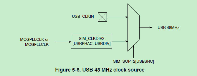

Hui_Ma
Hi Robert,
MK22FN1M0VLQ12 USB clock source as below picture shows:
From the MCG register setting, the MCGPLLCLK is 120MHz and USB clock with 2/5 divide will get 48MHz clock.
That code setting should will get the correct USB clock.
