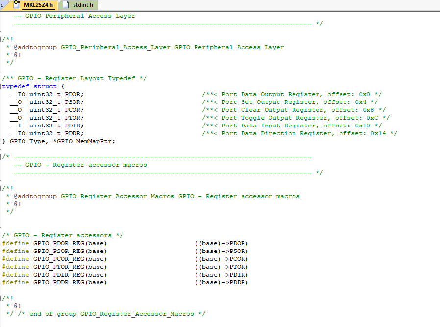

Hi, I want to have one timer() function that I can call and to control each led with instead of having these three almost identical ones. I figure that I have to pass PTOR and SC to the function but I don't know how to declare registers as arguments...

In your case I would pass pointers to the TPM and port instances, plus the port B bit value.
void timerGeneral(TPM *ptrTPM, PT *ptrPT, unsigned long ulLED, volatile int* iterator, int* dtyCycMrkr, int* flag, float seconds, float dutyCycle){
 if(*flag){
 *iterator *= seconds; *flag = 0; //Timer overflows 650 times a second(Hz)
 *dtyCycMrkr = dutyCycle * *iterator;
 if(ptrTPM->SC & 0x80){ //Timer must overflow 6 times before changing LED state
 if(*iterator == 0 || *iterator == *dtyCycMrkr){ //Time overflows for the 6th
 ptrPT->PTOR |= ulLED; //LED state changes
 if(*iterator == 0)*iterator = seconds * 650; //Overflow tracker set to 6
 ptrTPM->SC |= 0x80; //TOF cleared
 *iterator -= 1; //Tracks how number of overflows and decrements by1
which gives your main loop of:
#define RED_LED   0x40000
#define BLUE_LED  0x02
define GREEN_LED  0x80000
while(1){
 timerRed (TPM0, PTB, RED_LED, rItrPtr, rDtyCycMrkrPtr, rFlgPtr, 3.0, 0.8);
 timerGreen(TPM1, PTB, GREEN_LED, gItrPtr, gDtyCycMrkrPtr, gFlgPtr, 0.5, 0.2);
 timerBlue (TPM2, PTD, BLUE_LED, bItrPtr, bDtyCycMrkrPtr, bFlgPtr, 4.0, 0.3);
You just need to find out what the name of TPM and PD structs actually are in your environment.

Thanks, Mark! I right clicked "PTB" in Keil and clicked  "Go To Definition Of PTB" and it took me to the macro where "PTB" was defined as GPIOB. I went to GPIOB's definition and it took me to this:
//from MKL25Z.h
/** Peripheral GPIOB base address */
#define GPIOB_BASE (0x400FF040u)
/** Peripheral GPIOB base pointer */
#define GPIOB ((GPIO_Type *)GPIOB_BASE)
#define GPIOB_BASE_PTR (GPIOB)
So the Port's struct was typedefed to GPIO_Type *  so, I used that as that as my parameter type.
I followed the same steps for TPM.
This is how my timer function looks like now:
prototype:
void timerGeneral(led*, GPIO_Type *, uint32_t, TPM_Type *, uint32_t, float, float);
definition:
void timerGeneral(led* myLed, GPIO_Type *port, uint32_t toggleMask, TPM_Type *timer, uint32_t statCtrlMask, float seconds, float dutyCycle){
