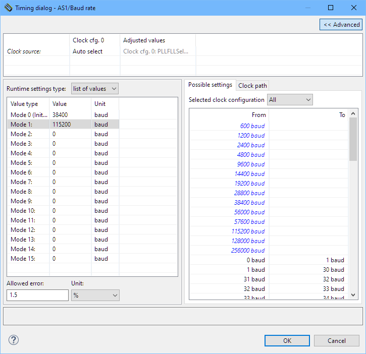

Or: set the baud rate to 'list of values' (I'm not having a KL27Z, but I'm doing that with the KL25Z):

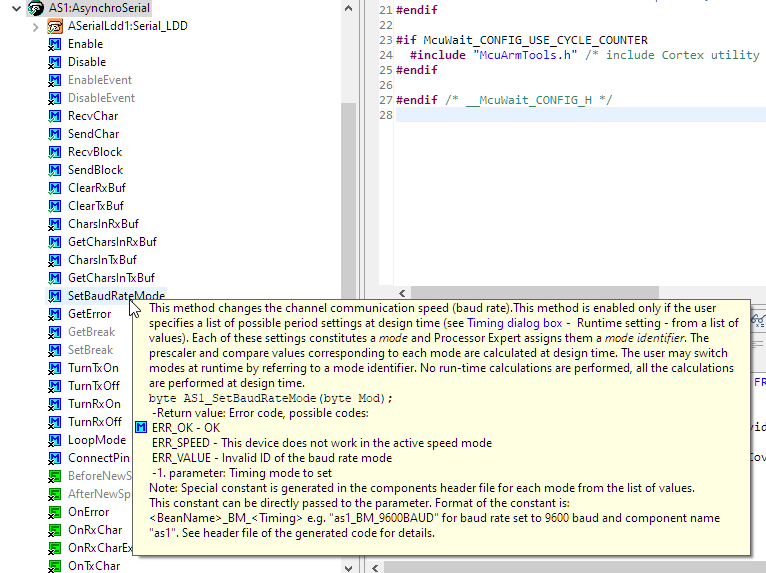

Then use SetBaudRateMode:

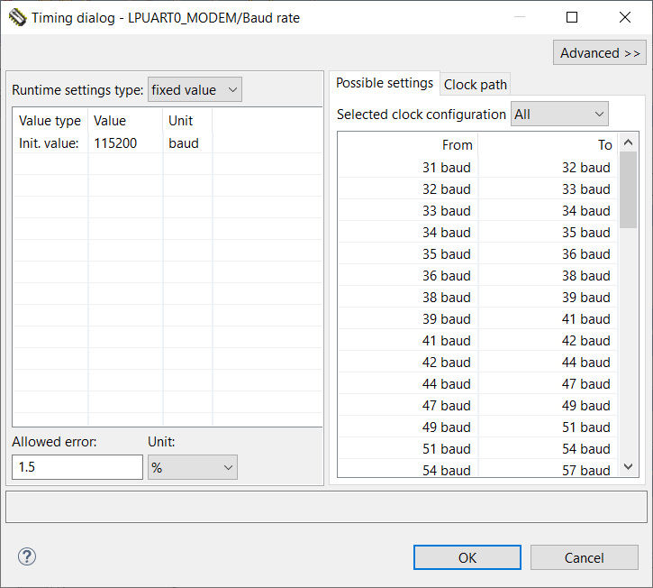

I searched in processor expert the AsynchroSerial component, but i cant find it to kl27Z.
I also looked at the LPUART configuration in processor expert and cannot add more baud rates to the list.
Do you know what could be the solution?

Can you change the drop box of the 'Runtime settings type' to 'list of values'? Then you should be able to add more rates.
