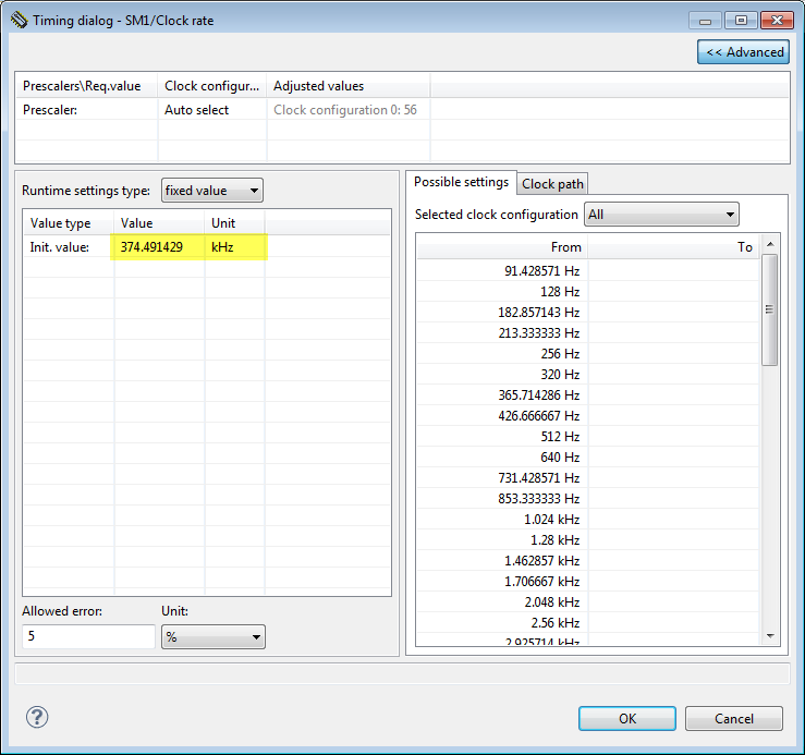

kbm
Hi Erich,
Thanks a lot ! I was wondering how I can change the clk rate of SPI ? I tried but it seems that the values are unachievable with the current settings.
2,751 Views

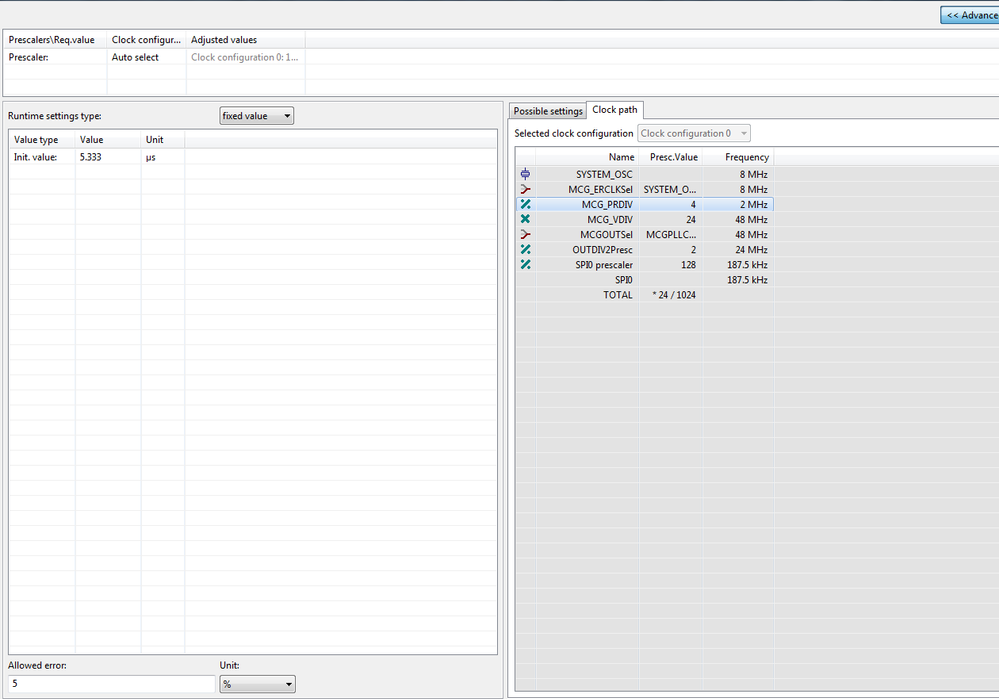

BlackNight
You set the SPI clock here:
The clock path is only to illustrate how that clock is built up.
Processor Expert can automatically select the prescalers for you, so you do not need to do this by hand.
