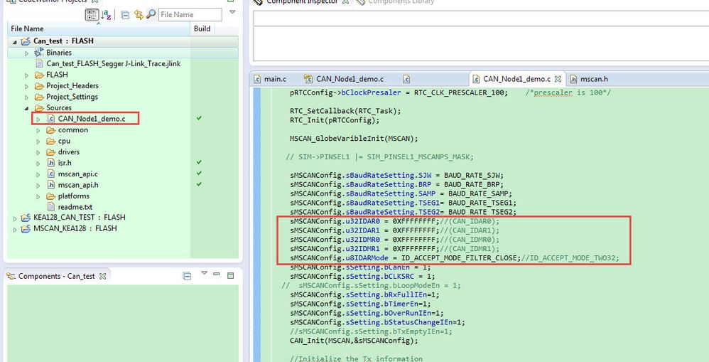

I'm using KEA-128, and I want to read all the CAN mesages in the CAN bus, I need to extract the id and the data frame of the CAN mesages. If I'm using the attached program that I download from this discussion

Hi Emillio,
    If you want to read all the CAN messages, you don't need to add the identifier mask, this will receive all the ID data.
    For detials, please refer to my attached code, this code can receive all the CAN message, and will printf the received CAN ID, lengh, and data frame.
  The following picture is the configuration of  receiving all the MSCAN data:
  After receive the data, you can get the data from structure sRxFrameInfo.
  My test result is:
Running the TRK-KEA128 CAN_Node1_demo project.
receive a frame data!
ID is 0x8!
Data length is 8
0x11,0x22,0x33,0x44,0x55,0x66,0x77,0x88,

    You can find all the receive information is printf out.
Wish it helps you!
If you still have question, please let me know!
Jingjing

I have one last question, I hope, to read an specific id for example 0x54, what do I need to put in the IDAR0, IDAR1, IDMR0, IDMR1? Or do I need only to change the Node_id's?
Can you give me an example whatever Id? I have read the sections 32.3.17 to 32.3.20, but I don't understood very hoy the mask of IDAR0, IDAR1, IDMR0, IDMR1 works. Do you have an example of what do they do step by step?

kerryzhou
Hi Emillio,
