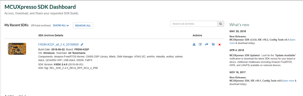

How can I download a complete KSDK 2.x with examples? The website is only downloading for a board w/o examples. Anything else sends you in a loop.
2,926件の閲覧回数
apluscw
I believe the KSDK builder website is broken. You can download an SDK for a specific dev board but that doesn't include various examples of how to use the SDK. When you click along other paths you are simply going around in a loop.
I specifically need an example of the SPI/DMA for the K22F family using SDK 2.x

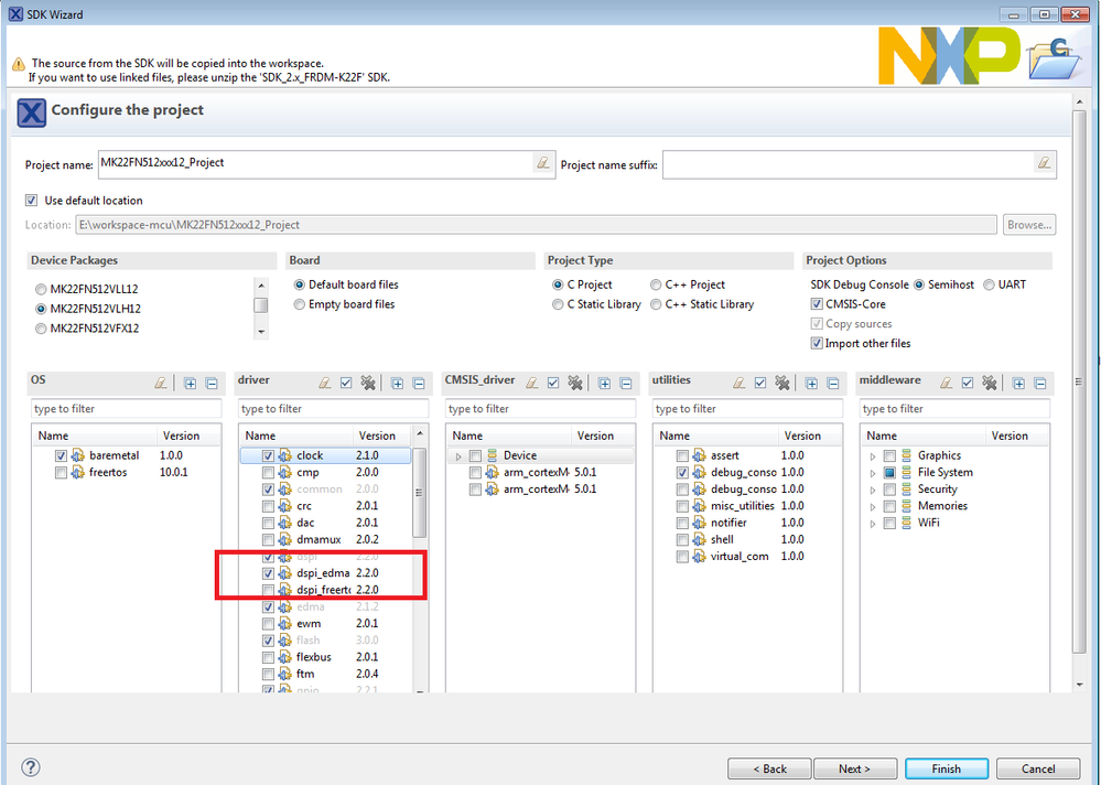

danielchen
Hi Tharon:
Could you please let me know how to reproduce your issue? I downloaded the latest SDK version 2.4 for Frdm-k22f board, select all components, I can see the dspi edma drivers, please see the blow picture.
2,385件の閲覧回数
apluscw
Hello, Daniel,
   So in regards to your original reply, I think because I was trying to get an earlier SDK 2.0 or 2.1, my efforts fell into a gap on the website. When I just went for the latest SDK using the 144-pin part, I was able to get a download of SDK 2.4 and it did include examples nearly identical to the one I found at github.
TH
2,385件の閲覧回数
apluscw
What I am looking for is example code on how to use the DMA and SPI for the K22F 144 pin 1M device. I already have the full SDK driver code in the existing project, but I need the example code.
I don't know if it is the latest, but I have been moving forward after locating a copy of the K22F-FRDM SDK with all the examples on github. Had to do some homework to map it to the 144 pin device and still working with it.
