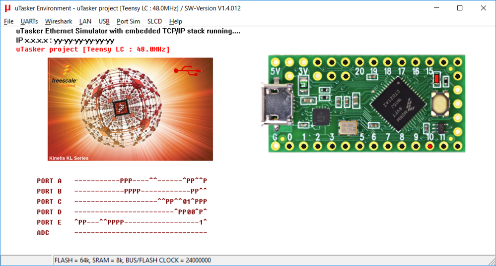

I tried on the Teensy LC with the TPM clocked from most possible sources (32kHz slow clock, 4MHz fast clock, direct from the 16Mz oscillator and from the PLL at 48MHz). Since this board doesn't normally have and debug capability I checked first in the uTasker simulator:
Attached is a binary for the TEENS-LC that is set up with a terminal interface on the USB, which you can load with the Teensy Loader program.
I set up to have TPM0 clocked from the PLL and the input to the counter to be from TPM_CLKIN1 (this is pin 26 (the hole below the top right one in the image above)).
If you connect to the CDC with a terminal emulator you can do memory debugging (to check all register content).
1. Hit enter key to get main menu
2. Enter menu 3 (I/O menu)
3. Now you can monitor registers
"md 40038000 l 4" displays the timer registers where the count value can be seen.
Each time there is a pulse on the clock input this counter increments as expected.
Every 480 pulse it will reset (due to the overflow value that is set).
I didn't notice what was wrong with your code but if you use the memory display command you can compare all of the register settings with those that you have and possibly identify the error.
