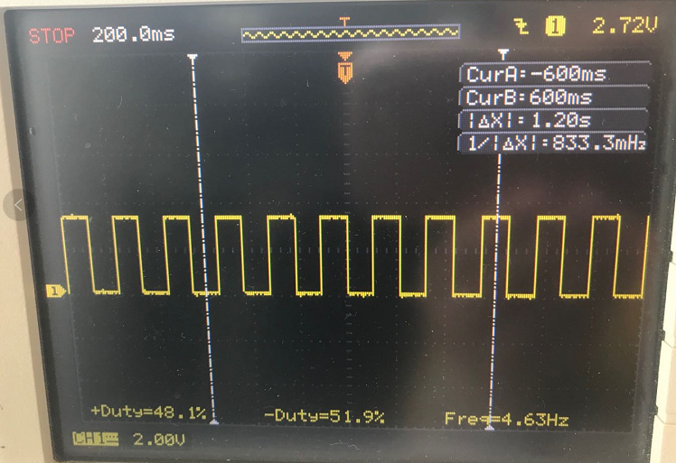

Hi Amine,
 Do you test the board directly or with the TWR-ELEV board?
  I just test the TWR-K60D100 board directly, then test the A16.
I test the SDK gpio_led_output project in the SDK code, which can be downloaded from this link:
Welcome | MCUXpresso SDK Builder
I modify these point:
#define BOARD_LED_ORANGE_GPIO_PIN 14U //11U
void BOARD_InitPins(void) {
  CLOCK_EnableClock(kCLOCK_PortA);                           /* Port A Clock Gate Control: Clock enabled */
  CLOCK_EnableClock(kCLOCK_PortE);                           /* Port E Clock Gate Control: Clock enabled */
  PORT_SetPinMux(PORTA, PIN11_IDX, kPORT_MuxAsGpio);         /* PORTA11 (pin L9) is configured as PTA11 */
  PORT_SetPinMux(PORTE, PIN8_IDX, kPORT_MuxAlt3);            /* PORTE8 (pin F3) is configured as UART5_TX */
  PORT_SetPinMux(PORTE, PIN9_IDX, kPORT_MuxAlt3);            /* PORTE9 (pin F2) is configured as UART5_RX */
    PORT_SetPinMux(PORTA, 14u, kPORT_MuxAsGpio);    //kerry add
Then test it, the PTA14 GPIO wave is:
You can find it works OK.
So, please try it again on your side.
Kerry

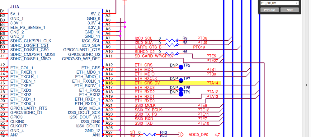

aminesedki_as
Hi Kerry thanks for u feedback
I use a TWR-K60D100M
PIN number PTA14  (GPIOA L10) A16 on J11A
I juste set the pin as an ouptut and take a 0 logic as an initial value (no pull up)  and generate the configuration via config tools than update the project.

kerryzhou
Hi Amine,
Kerry

aminesedki_as
Hi Kerry,
I modify the project like u tell me than it work fine thank u.
