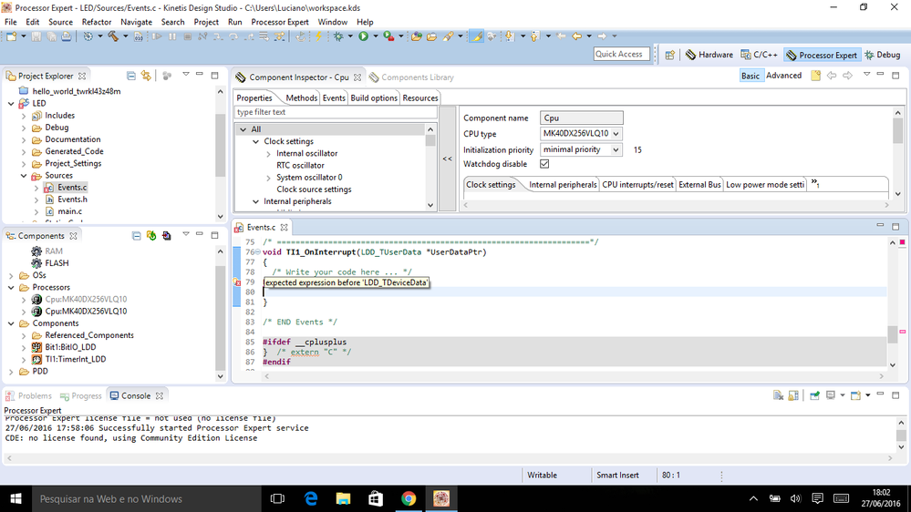

Hi support! I am learning to programing a Kinetis K40 and traing to toggle a led using de comand Bit1_NegVal().
I recieve the error: expected expression before 'LDD_TDeviceData'.
How a sove this problem?

can you share your project?
That message from the compiler sounds like you are not properly including the header file(s).

Hi Luciano,
I get an error because you try to call Bit1_NegVal() without the device handle (and this is not what you have in your screenshot):
void TI1_OnInterrupt(LDD_TUserData *UserDataPtr)
  /* Write your code here ... */
Bit1_NegVal();
Correct is:
  Bit1_NegVal(Bit1_DeviceData);
Then things compile properly on my side.
