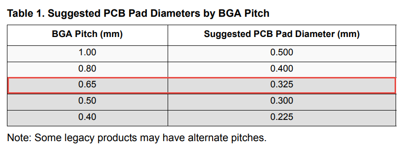

Hi I am using your new Processor MK27FN2MOVMI15. the pitch is 0.65 . I want to know what is the smallest Via size Pad and Hole size that I can use, for production of these Boards. We want to mechanically Drill, as this keeps the board cost down.

There is an application note AN4982 about MAPBGA package.
More detailed info please check here.
For pitches at or below 0.65 mm, the solderable diameter is generally larger than one-half pitch in diameter:
Wish it helps.
Mike

Thanks but my question is do I have to go Micro-via.  or can i have a via in the channel to escape tracks out. Much appreciated.

Sorry for the later reply.
Please refer the FRDM-K28F board PCB design files from below link:
FRDM-K28F - Printed Circuit Board bill of Materials and Design Files
FRDM-K28F|Development Board|Kinetis K27/K28|NXP
There provides the MK28FN2M0VML15 chip BGA fan-out reference design.
Wish it helps.
Mike
