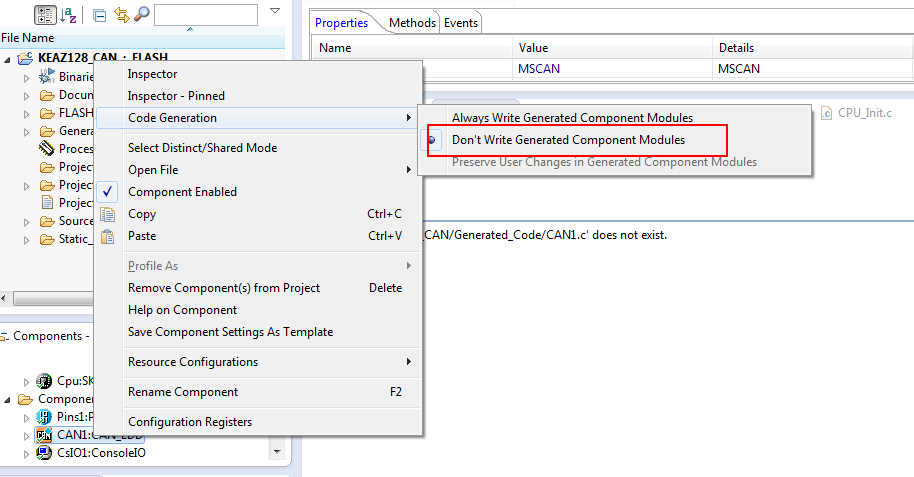

Add, after you add the code i mentioned , please select the "Don't write generated component modules", or when you click the generate code button, the code
will be disappear .
Hope it helps

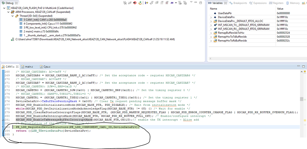

Omar What did you do to make it work? I used the attachment  she uploaded but I cannot step after the "PE_LDD_RegisterDeviceStructure(PE_LDD_COMPONENT_CAN1_ID, DeviceDataPrv);" the code gets stuck, and I havent changed anything in here code. but does not run, loop mode already worked for me

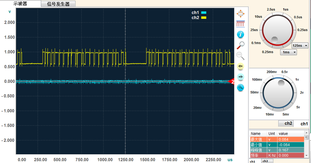

1. One method you can use a can-usb convetor , then check the data which CAN send on the PC terminal ;
    Another method you can use the logic analyzer , or simple oscilloscope ( this only can check whether it can signal).

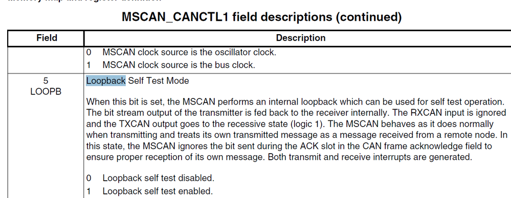

2. There is the  option that disable or enable the loopback mode :
you also can use the register :

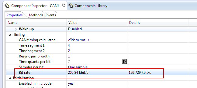

3. Configure the baud rate at here :

I was trying to debug my project with no success, I change some few things according to the help Components for CAN_LDD, like Loopmode=NO and Bit Rate.
Could you please review my attached project  to see if it is really sending/receiving a Frame for NOT Loop mode mode?

First change the loop mode to"no" , then i can see the transmit data from the oscilloscope:
you can also test it on your side . while at this time it not run to the Tx interrupt.

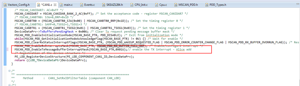

Second , there is a bug on the PE code , it have not enable the CAN Tx interrupt , please add
this code at the CAN1_Init() function:
then you can see it can run to the interrupt function of TX .
I attach the project , hope it helps
will be disappear .
Hope it helps
Alice

tonymor90
Hello Alice, I was trying to run your example code, but the implementation does not continue  "PE_LLDD_RegisterDeviceStructure( PE_LDD_COMPONENT_CAN1_ID, DeviceDataPrv);
