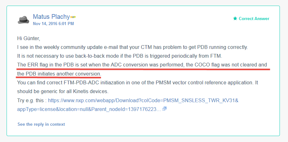

I find below thread about PDB channel sequence error:
Using PDB on K22FN128

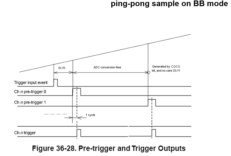

There are two types of ADC working way in ping-pong mode, please check below picture for the detailed info:
Type 1: using two PDB pre-trigger of PDB channel:
Type 2: using back-to-back mode:

Thanks.  I think what was throwing me off was the description of the sequence error in the manual:
Sequence error detected on PDB channel's corresponding pre-trigger. ADCn block can be triggered
for a conversion by one pre-trigger from PDB channel n. When one conversion, which is triggered by
one of the pre-triggers from PDB channel n, is in progress, new trigger from PDB channel's
corresponding pre-trigger m cannot be accepted by ADCn, and ERR[m] is set. Writing 0’s to clear the
sequence error flags.
And later:
A sequence error typically happens because the delay m is set too short and the pre-trigger m asserts
before the previously triggered ADC conversion finishes.
Both of these only describe the conversion being in progress and make no mention of clearing the COCO bit.  A more accurate description of the sequence error bit (top quote) would have saved me some trouble.
