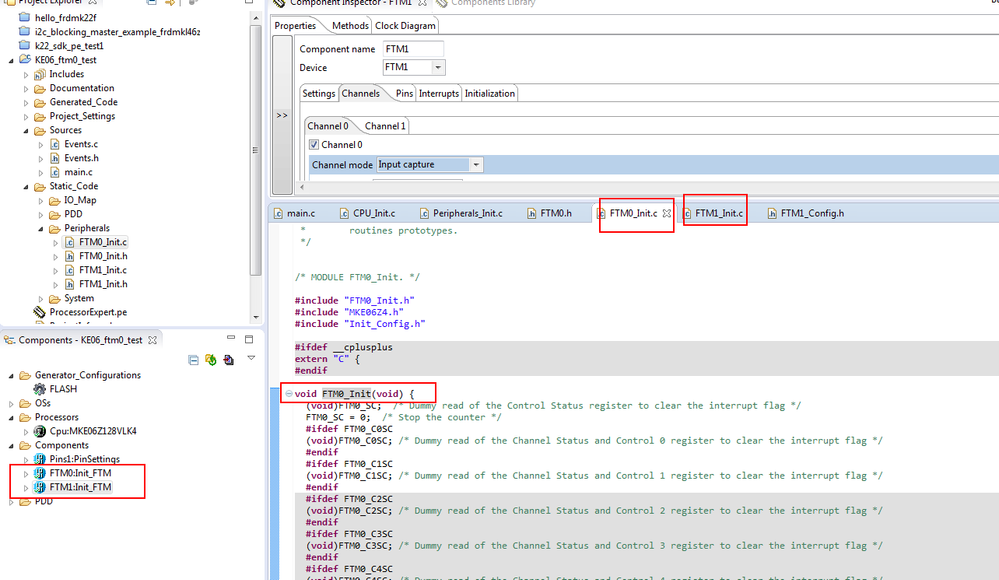

I'm seeing a hard fault exception when configuring FTM0 or FTM1 (both 2 channels) on a MK02Z16 device (also tested on KE06Z with same results).  The same code sequence works fine on FTM2 which 8 channels so not sure if that's a factor.  All of the example code I've found is for FTM2.
The code is simple:
SIM->SCGC |= SIM_SCGC_FTM1_MASK;
FTM1->MODE |= FTM_MODE_WPDIS_MASK;
The second line generates a hard-fault.  However writes to certain FTM registers do not generate hard faults (for example a write to the SC register is OK, so it appears that writes to legacy TPM registers are OK).
Is anyone aware of special considerations for FTM0 and FTM1 on E series devices?

Hello Jonathan,
(For example  the KE06 )
- Which IDE do you  use , could you show all the code of  the FTM0 initialization ?
- The FTM0/FTM1 with basic TPM functions , the FTM2 module with full functions , also the available registers are different .
    (You can refer to the Reference manual pg82)
- If you use KDS or CW , you can use the PE to configure it , then you can see the generate code like this :
Hope it helps
Alice

Thanks Alice.  I didn't realize that FTM0 and FTM1 are not really FTM modules but TPM modules.  It's confusing because the FTM chapter lists registers that don't actually exist!  I wish that the reference manual chapters were specific to the actual functionality of the part.
I've changed my code to use TPM functions only for FTM0 and FTM1.
