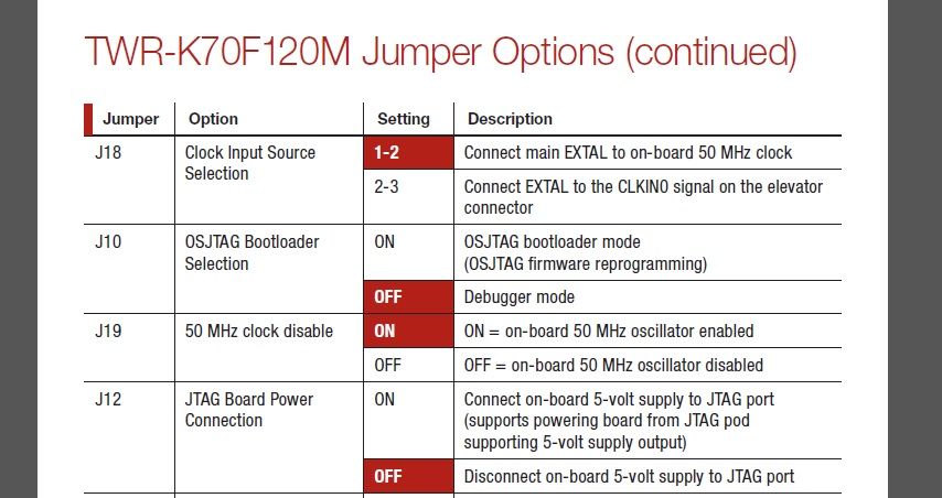

hi, im writing because i have a problem with TWR-K70F120M board.
I want to probe an example project (blinky led) with codewarrior 10.6 into the board. When I debug the project with Pne U-MultiLink I get an error message: "The embedded firmware needs to be in bootloader mode to update. Please unplug the USB cable, insert a jumper on the 2-pin bootloader header (connecting JM60 IRQ to ground), and reconnect the USB cable."
I have already jumped the J10 pin but im getting the same error. I want to get in the debugger mode to download the example to the board. What am i doing wrong?

CW10.6 is trying to update the debugger on your board (it has detected that it has an older version).
If you follow its instructions it should be able to complete this task and then you can start loading your own code to the board.
