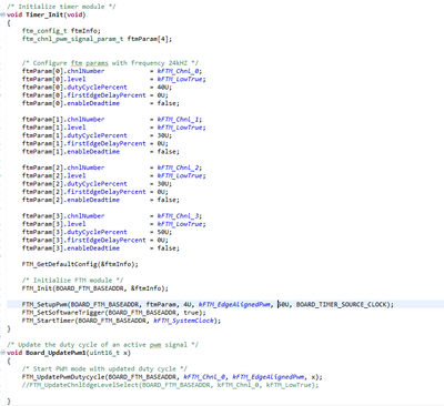

Hi! I am using FRDM KE16Z and i have sdk 2.13. I setted up the FTM driver for generating pwm on FTM0 ch0, ch1, ch2, ch3. I put a wire on pin no 23, wich is PTC0 and i see nothing on the osciloscope. The other function in the photo is for updating the pwm dutycycle.  In main is just called the init function and in while(1) part i just updated the pwm dutycycle and added a delay after.

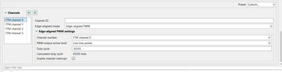

I also added photos with pin and peripherals tools.
TY!

I changed the order of functions in init function, but he output is visible on the blue led, not on the pins. Why? TY!
4,169 次查看
Andrei13
Forgot to add this photo from pins. One is with label and identifier bc i tried  to see if that s the problem, but it isn t.
