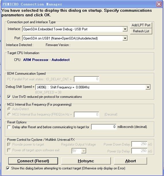

crezyoz
I just began experiencing the exact same issue. I resolve it by setting the speed of the Multilink to 0.2 Mhz instead of 1Mhz.
Though I find it interesting because the prompt doesn't say what device is secure.
6,919 Views
kevintai
My development environment FRDM-KL25Z and  KEIL
I can not find the setting of Multilink speed.
6,919 Views
BlackNight
It is that 'debug shift speed' in your screenshot.
Try adjusting that setting.
Hope this helps,
Erich
6,919 Views
kevintai
I try all the speed, but the issue is still here.:smileyangry:
