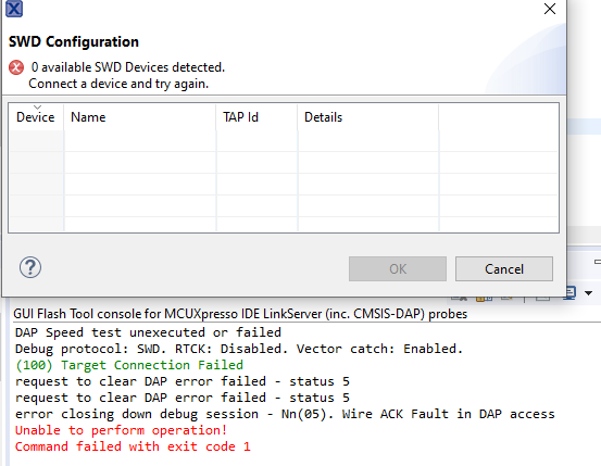

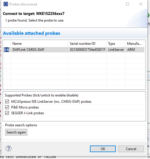

I am having a problem. When trying to initiate Debug, the probe is detected:
But when I pressed OK button, it cannot access to SWD link:
I tried with reset button, restart my computer, but none of them work. How can I fix this?

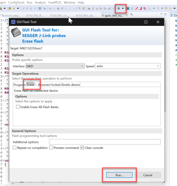

Alexis_A
Hi Nguyen,
Could try using the erase feature from MCUXpresso to see if the firmware did lock the MCU?
Alexis Andalon
5,357 Views
daonguyen3154
Hi Alexis,
I tried with the GUI Flash tool, but when I chose Mass erase, it still cannot find SWD link
Best regard,

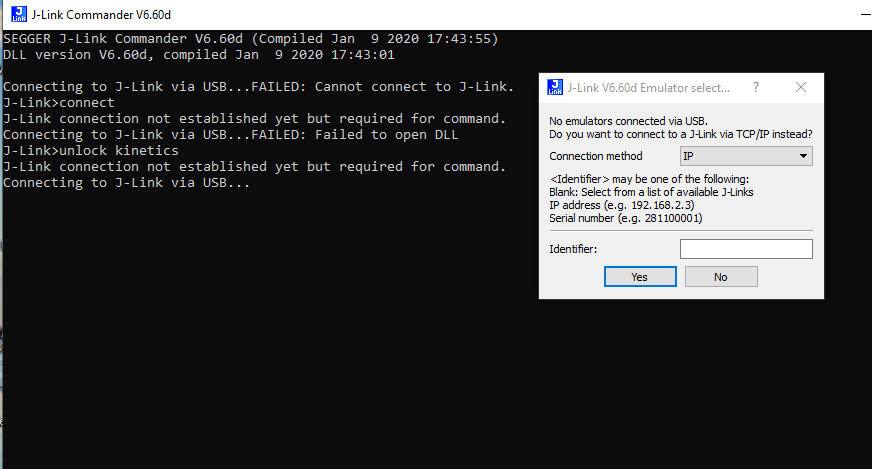

Alexis_A
Hi Nguyen,

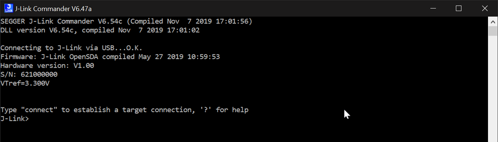

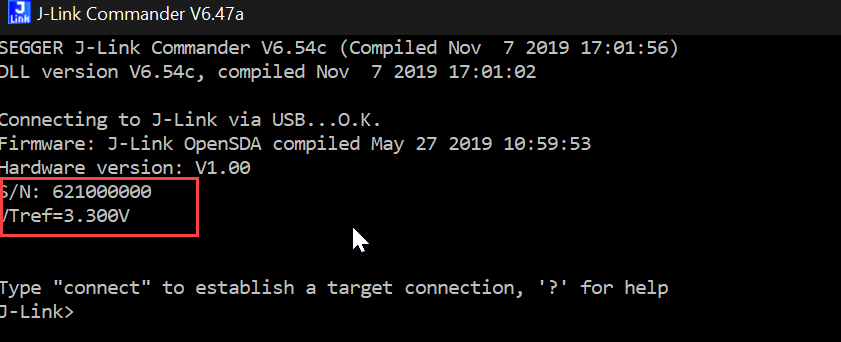

Can you let me know which MCUXpresso version are you using and could you try updating the firmware to the one from segger and do the following test?
-Open the J-Link Commander and check that the power is around 3.3 V
-Type the following commands:
   -connect
   -? (Found your MCU)
   -s (SWD)
   -Enter (Default)
And check if it can be connected, if this doesn't happen try the command: "unlock kinetis"
Let me know if this helps you.
Alexis Andalon
5,357 Views

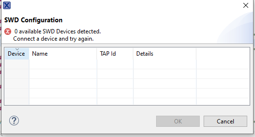

daonguyen3154
My MCUXpresso IDE version is 11.0.1_2563
When I tried to connect, It cannot recognize my chip and show up a table like this.
Best regard.

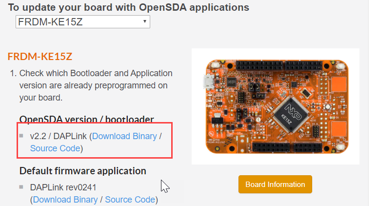

Alexis_A
Hi Nguyen,
Could you try again to change the debugger firmware to the DAPLink one?
After this opening the J-Link Commander the following log should appear, if this no happens something is wrong with the K20 debugging chip.
Alexis Andalon

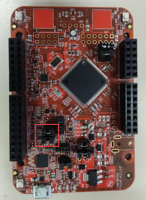

daonguyen3154
I have a J-link debugger, which headers should I remove to test the MCU work or not?
Best regards.
5,357 Views
Alexis_A
Hi Nguyen,
This are the headers you need to remove:
pastedImage_1.pngBest Regards,
Alexis Andalon
