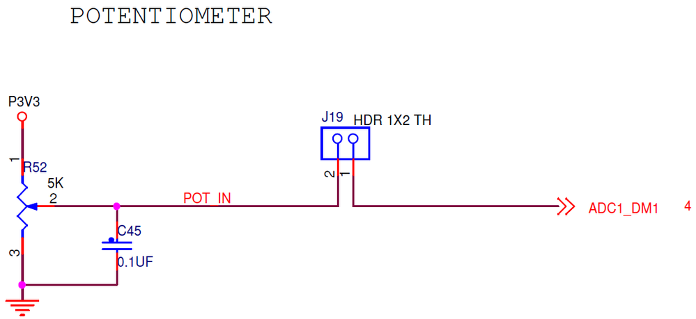

This example make the measurement of the potentiometer on the ADC1_DM1 channel, as shown below:

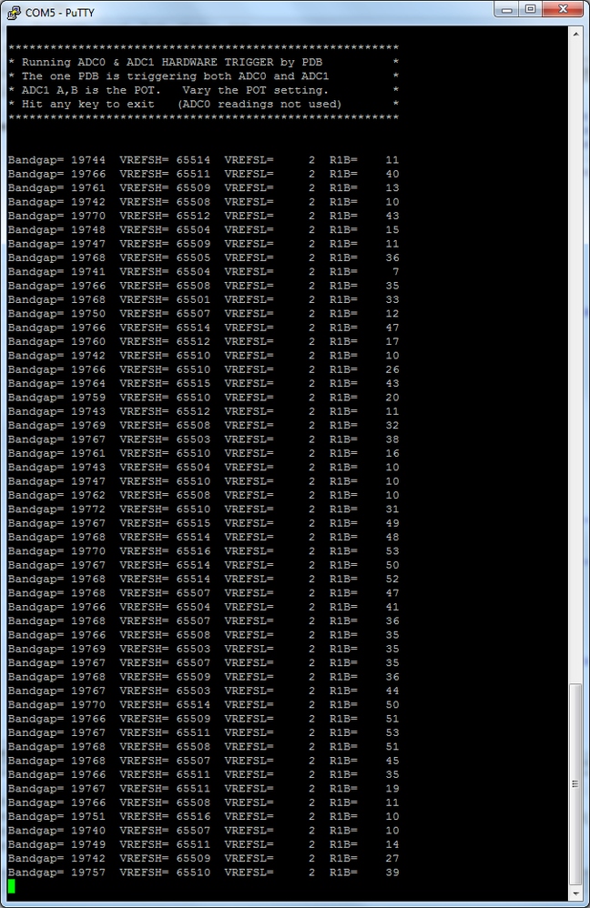

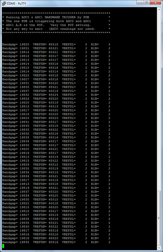

When the potentiometer is at 0V position (I also put the ADC1_DM1 pin on GND to make sure that the value is 0V), I have unstable measurements of this ADC channel after a reset (either at reset button SW3, or reset by IAR software).
Below the stable measurement:
After the reset, we have the following values, with a wide variation in R1B (potentiometer channel):
After a few more resets it back to be stable.

- PMC_REGSC |= 1;        // To enable the bandgap buffer to read bandgap value.
- Master_Adc_Config.STATUS1A = AIEN_ON | DIFF_SINGLE | ADC_SC1_ADCH(0x1B); // Bandgap Read in ADC0_RA.
- Master_Adc_Config.STATUS1B = AIEN_ON | DIFF_SINGLE | ADC_SC1_ADCH(0x1B); // Vrefsh read in ADC0_RB.
- Master_Adc_Config.STATUS1A = AIEN_ON | DIFF_SINGLE | ADC_SC1_ADCH(0x1E); // Vrefsl read in ADC1_RA.
- Master_Adc_Config.STATUS1B = AIEN_ON | DIFF_SINGLE | ADC_SC1_ADCH(ADC1_CHANB);             // Potentiometer read.
- printf("Bandgap=%6d  VREFSH=%6d  VREFSL=%6d  R1B=%6d\r\n", result0A,result0B,result1A,result1B);        // To show the results in console (UART).

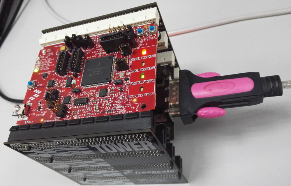

I had done a same test with TWR-K60F120M board (SCH-27167 rev C1) and below is the test hardware platform:
I don't modify any hardware design and during the test, the ADC conversion result is stable.
Please check my test result video record.
I am using [FLASH-1M] target and program the TWR-K60F120M board with debugger tool connection.

In the SCH-27167, what the difference between rev C and rev C1?
Did you make the reset by the SW3 button? If so, could you try to make the reset by debugger software?

The difference between Rev C vs. Rev C1 is Rev C1 just replace two obsolete resistors (R13 and R14) with new resistor part number, which does not affect Potention-meter circuit.
