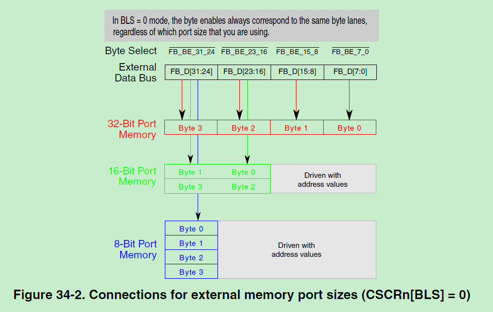

I am going to use 2 32-bit SDRAMs on SDRAM controller. And want to add 16-bit external flash to Flexbus.
Could anybody check if the following pin assignment should be OK if I don't want to use external multiplex circuit?

1> When BLS=0, FB_AD[0:15] will be driven as address during FLEXBUS read/write. And at the same time, FB_A0~~FB_A25 will be driven as address during FLEXBUS read/write.

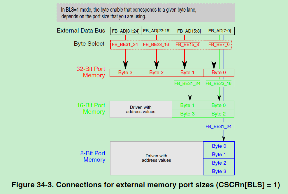

2> When BLS=1, FB_AD16~~AD31 will be driven as address during FLEXBUS read/write. And at the same time, FB_A0~~FB_A25 will be driven as address during FLEXBUS read/write.
The SDRAM and Flexbus multiplexed pins was automatically switched, customer could refer AN5095 about some detailed info.
Wish it helps.
Ma Hui

Hui_Ma
The Flexbus data-byte alignment and physical connections based on FB_CSCRn[BLS] bit setting:
During the Flexbus operation, the FB_A[0:25] pins are always driven as address function. Customer can use those pins as Flexbus address pins.
Wish it helps.
Ma Hui

Thank you for youe answers. I just want to confirm the following because I am doing the hardware design for now.
I am using FLEXBUS for 16-bit operation:
1) If BLS=0, FB_AD0~~AD15 will be driven as address during FLEXBUS read/write? And at the same time, FB_A0~~FB_A25 will be driven as address during FLEXBUS read/write? So, I can use FB_AD[0:15]+FB_A[16:25] as no multiplex address and will be the same function as I use FB_A[0:25]?
2) if BLS=1, FB_AD16~~AD31 will be driven as address during FLEXBUS read/write? And at the same time, FB_A0~~FB_A25 will be driven as address during FLEXBUS read/write? So, I can use FB_A[0:15]+FB_AD[16:25] as no multiplex address and will be the same function as I use FB_A[0:25]?
All above signals will be switched automatically between SDRAM and FLEXBUS operation? Do I need to configure for FLEXBUD multiplex/non-multiplex mode?
Christie
2,750 Views
Hui_Ma
Wish it helps.
Ma Hui
