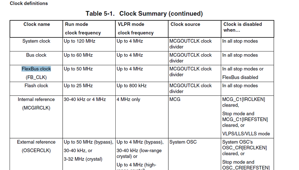

Hi, Martin,
You did not mention the part number you are using, anyway, I suppose you use Kinetis for example K64.
Regarding your question, I suppose that the issue is related to the layout of the address lines, I give you two suggestions:
1)set the EXTS bit in FB_CSCRn, which will extend the address latch signal.
2)decrease the FlexBus clcok frequency. For example, the maximum FlexBus clock frequency is 50MHz for K64, if you reduce it to 25MHz, what is the result?
Hope it can help you
Xiangjun Rong
I post the clock distribution for K64:
