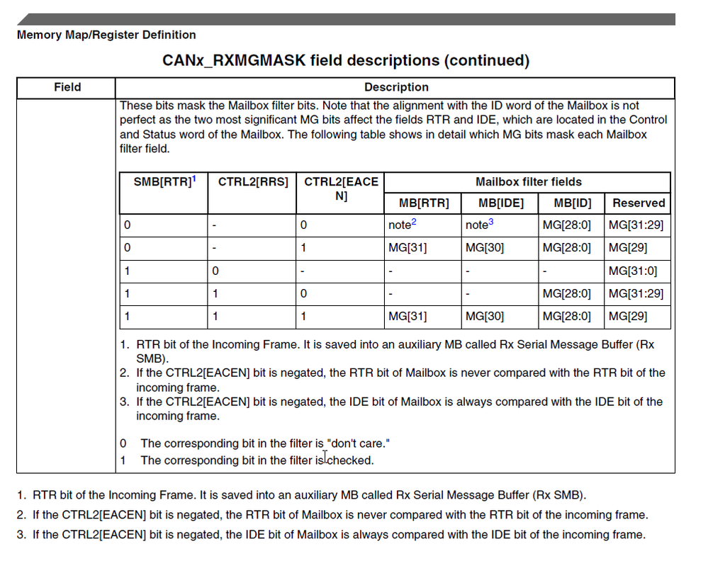

Hi Nitin verma,
There is a register called "Rx Mailboxes Global Mask Register (CANx_RXMGMASK)", which is for all the Message Buffer excluding MB14-15, since you used MB1 and MB2 in your application  code, you may just set up this register to ignore the ID checking, Please kindly refer to the following for more details.

nitinverma
Hi Kan_Li,
Thanks for the reply.
Now I have used register CAN_RXMGMASK with bit position 18 to 28 set as zero(i.e dont care) for Standard ID's.Now in this case I am getting an reception interrupt for Tx ID's as well.

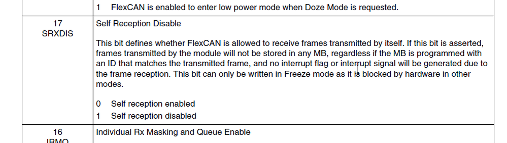

Kan_Li
Hi Nitin verma,
Please kindly check Module Configuration Register (CANx_MCR), and if bit 17 is set or not. Please kindly refer to the following for more details.

2,001 Views
nitinverma
Hi Kan_Li,

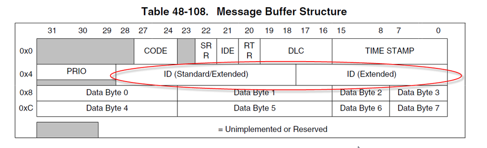

Kan_Li
Hi Nitin verma,
The APIs use the ID parameter to set up the corresponding message buffers, like below:
so if you set the mask register to check all the bits in the ID field, it would take effect.
and as I said before, there are another two mask register for MB14 and MB15, so it is possible to implement that function, but as the matching process always goes from the lowest number Message Buffer toward the higher ones, you have to set MB1 with ID 0x12 as RX buffer, and MB14/15 set to receive all other remaining ID's except 0x12. so you also have to set MB1's ID as 0x12 and the global mask register should set to check each bit in ID field to match 0x12, and mask register for MB14/15 can be set to ignore any ID.
