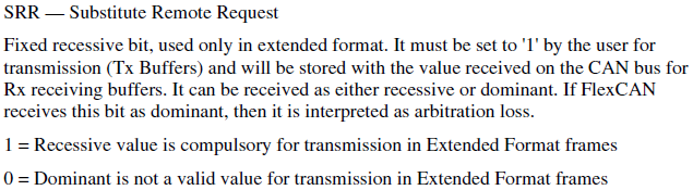

Sure enough, the line i thought was calling the set was never getting called, i manually set the bit, and now my CRC checks out and my other controller accepts the message. Thanks for the help Earl. I will note, the error was in generated processor expert code, is there a place to report incorrectly generated code?

Try with SRR set.
My Vector 'reference chart' says SRR will be recessive (1) for extended-ID messages.  My TX-prep code for the first MB word:
pFlexCANReg->MB[iTxMBNo].CS = FLEXCAN_MB_CS_CODE(FLEXCAN_MB_CODE_TX_INACTIVE)
          | FLEXCAN_MB_CS_SRR               //Always 'set' SRR
          | (bIDEin<<FLEXCAN_MB_CS_IDE_BIT_NO)
          | (bRTRin<<FLEXCAN_MB_CS_RTR_BIT_NO)
          | FLEXCAN_MB_CS_LENGTH(iNoBytes);
In any case, all we can say at this point is that some bit NOT shown by your logic analyzer is 'different', and the CRC is 'ok' because your receive-nodes ACK the message (so 'good' at the physical layer!) -- and this 'unseen content' is causing the message to be dropped, either directly by the receiver's message-filters, or by higher firmware layers.
Also, from a Kinetis Reference Manual:

I am not a PE user, so I can't help there.  These two bits are part of the overall 32-bit CAN 'lead in', and their content, like all else, is part of the message buffer you fill:
First word, bits 22 and 20 respectively.  I assume IDE is already '0' for extended...
I might guess that if any of these three bits are 'nonzero' as received, that the destination 'stack' might just toss them.
16,104件の閲覧回数
egoodii
Senior Contributor III
Sorry, SRR and IDE need to be '1' (been a while since I looked this close...).

These are old, stable modules -- I do not see how the CRC itself can be wrong.  I might assume that 'some bit in the sequence' not seen by your decoding-device is 'different' (one of the 'reserved' bits). I note that while your reference startup message starts with 5/1/1/3/1/2... bit times, the K64F is 5/1/1/3/1/5...  Decodes to the same extended-ID, but different SRR (12th bit in)?
IF your other nodes are NAKing this message, it is much more likely that your source clock is not 'exact enough' (which might also explain a decode-difference in your 'scope shots?).
