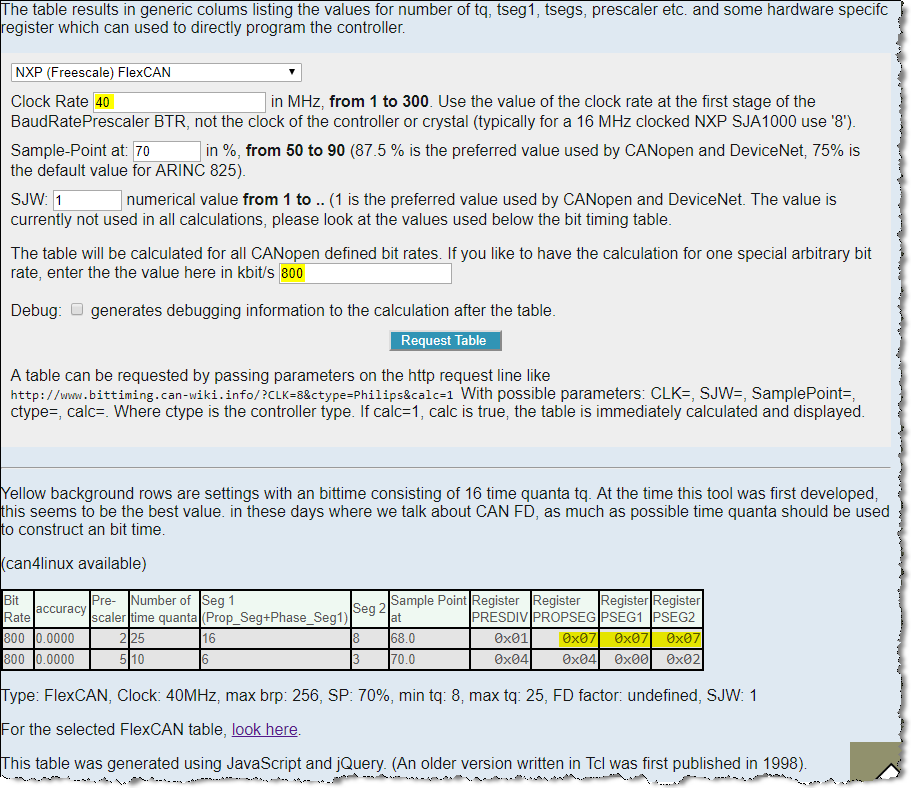

Hi - I have a MK22FX512AVLL12 with an 8M Osc and 40M Bus Clock. I have successfully setup the FlexCAN to run at 125K, 250K, 500K and 1M baud rate. I cannot get the 800K baud rate to work.  Can you point me in a direction of a tool to setup the PhaseSeg1,PhaseSeg2 and PropSeg to get that to work?  For the other baud rates I use

You can try to use the CAN Bit Time Calculation.
For example 800K baud rate:
    /* Init FlexCAN module. */
    flexcanConfig.baudRate = 800000U;
    flexcanConfig.timingConfig.phaseSeg1 = 7;
    flexcanConfig.timingConfig.phaseSeg2 = 7;
    flexcanConfig.timingConfig.propSeg = 7;
    flexcanConfig.timingConfig.rJumpwidth = 1;

Mark - This works great. Thank you so much. Can you tell me how to calculate these values? I don't see that anywhere in the video you pointed me to.  Can you provide me with the calculations done to get the PropSeg, PhaseSeg1, PhaseSeg2 and the JumpWidth. I was using this document from Freescale that doesn't give results like yours. FlexCAN Bit Timing Calculation.  Please advise.

Hi Mark - Thank you for your help and your quick reply.  I am using the CAN engine clock source as the peripheral clock, which is setup to be 40 MHz.  So that would make CAN_CTRL1 = 0x008b2002 and that doesn't give me 800K. I don't know how to use the uTasker project.  Can you retry with my peripheral clock? Thanks for the help.  What is the uTasker project?

If you are clocking from the 40MHz bus clock (note that generally the oscillator is recommended for less jitter) the values for 800kHz CAN bus operation are
- pre-scaler of 2
- phase buffer segment 2 length of 8
- time quanta of 25
which results in the register value of 0x01bf2007

Could you try with the value
0x008b0002 in CAN_CTRL ?
When I run the uTasker project for your chip and oscillator at 800kHz CAN bus it gives me a pre-scaler of 1, phase buffer segment 2 length of 4, time quanta of 6, which result in this register value.
If it works you can get the calculation routine from the open source uTasker project (in kinetis_CAN.h), where the following explanation is also given for the calculation.
