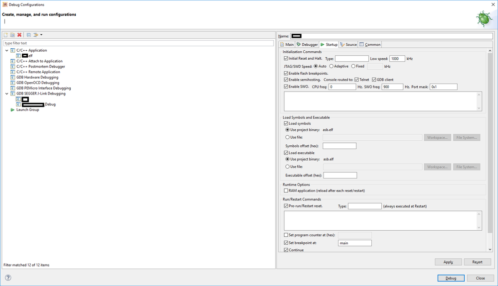

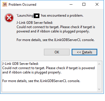

I'm new to KDS and i'm attempting to flash a custom board containing a Freescale MKL26Z256VLL4 Microcontroller through a 10-pin JTAG connection with a J-Link Base USB probe. I have already compiled my code and have the executable however when I attempt to flash it I receive this error:

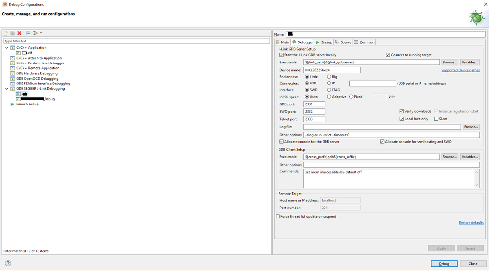

I am almost certain the board is properly connected because when I attempted to flash it on J-Flash I received a "connection successful" message and the boards com LED turned on. At the moment I cant use J-Flash due to licensing issues.  Below are my debug configuration settings on KDS, any help would be much appreciated.

2) I made a new work space and imported and compiled my project and i'm still running in to the same error while trying to flash. Does anyone think its a configuration issue?According to the guides online you dont need to do much if any changing to the flash configuration settings in order for it to work properly. Below is my J-LinkGDBServerCL:

Checking target voltage...
Connecting to target failed. Connected correctly?
GDB Server will be closed...
Shutting down...
Could not connect to target.
Please check power, connection and settings.
