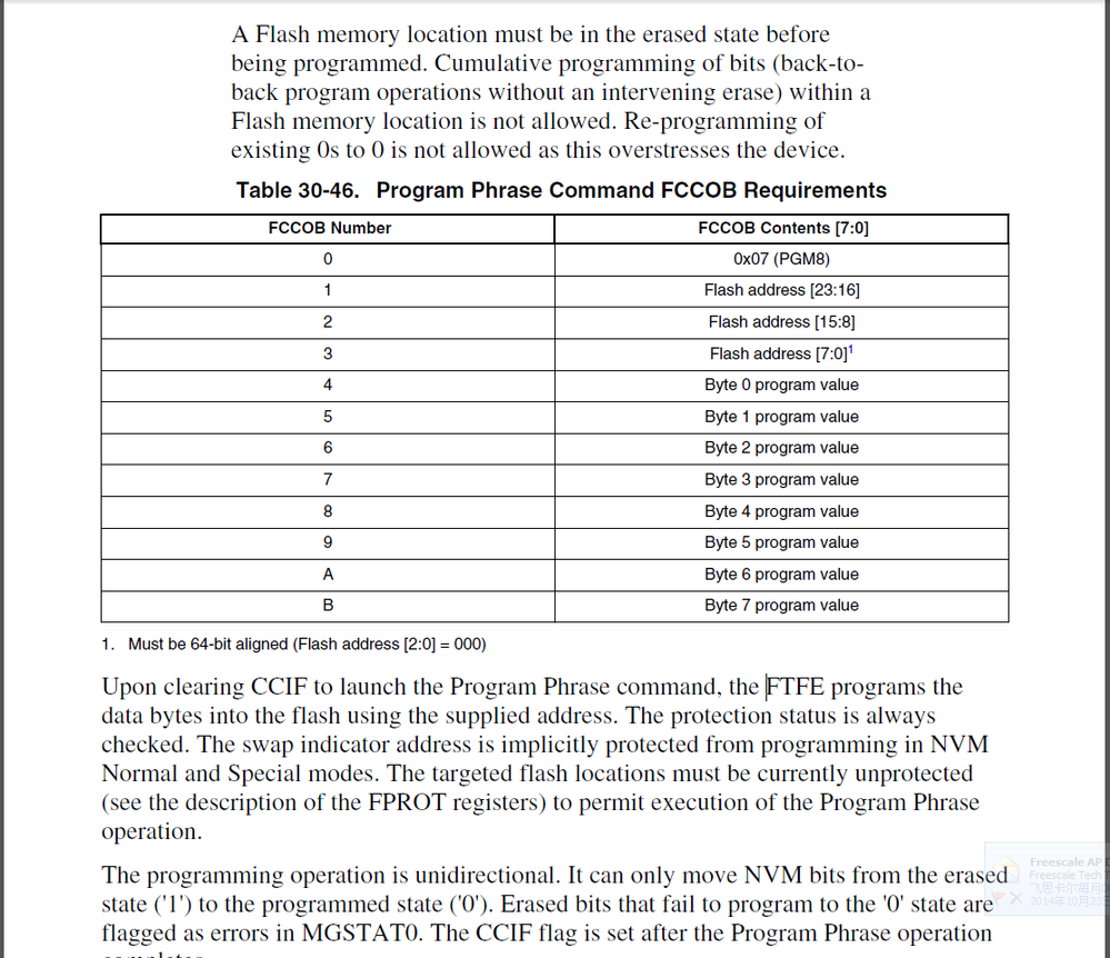

I am using K70 Microcontroller - MK70FN1MOVMJ12.
I want to write DDR to Flash. I am using Flash driver - flash_kinetis.c (I tried latest driver , but it is not writing to the flash at all, so I have used old driver -atleast it writes into flash)
If I mention my flash start address 0x8000 and the length is 256 . It is writing the all the locations(every 0x100) except
0x80F00,0x81F00,0x82F00 etc
I dont know why the flash driver is not writing to the specific location 0x80F00 (next 256 data is only 0xFFFFFFFF),0x81F00 etc (I see AccErr when I debug).

Have you erase the sector containing 0x80000 before programming? otherwise it would cause such issue.
Kan

I noticed you had not put the base address to be erased at the boundary of 4KB, for example, the 4KB boundary should be at 0x80000,0x81000,0x82000, while in your code, you use 0x80E00,0x80F00 as the base address,
for(original_address.complete = 0x80E00;original_address.complete < 0x90000;original_address.complete = original_address.complete+0x100)
          FTFL_EraseSector(original_address.complete);
            write_flash_ret = WRITE_FLASH_FUNC(original_address.complete, (LWord*)ram_data, length);

What is the value for length? I am sorry but I didnt find any definition for it. and after I review the flash driver you provided, I found you are using the phase access method, which program the flash with 8 byte once, that is correct as the length is 256 bytes less than the sector size, but in the implemenation, the flash command is for section program, have you modified the flash driver from www.freescale.com? I think that is why you found it wrote beyond 256 bytes.

I think you may use the program phase command, shown as below:
Our released flash driver has already implemented it, you may refer to the attachment for more details.  To download the whole flash driver, please refer to the link I provided previously in this thread.
