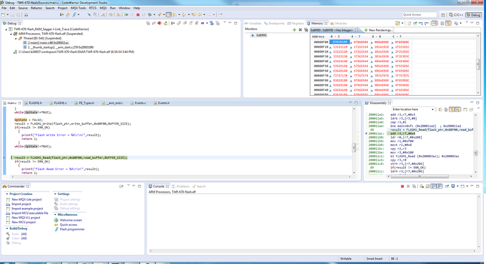

! !Hi Kotteeswaran G S,
I have tried to reproduce such issue on my TWR-K70F120M board, but my project works well on the address 0x80F00, so I suspected it might be a driver issue, and I used the flash driver from PE. Please kindly refer to the following for details.
I attached my project here, and You may try it on your board .
Hope that helps,
Kan
