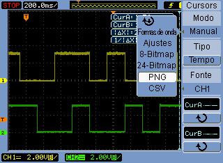

Hello everyone,
I'm using systick interrupt of the MKL05Z32 every 100us to build a base time in my program like this.
void SysTick_Handler(){
     if(!--time200ms){
          time200ms=TIME_200_MS;
          flag.change=1;
So I hope I get the flag "flag.change" set every 200ms. This flag is declared inside a struct with many others like this:
struct{
     unsigned char change:1;
}flag;
I'm using this flag to change a pwm frequency. I want to use 2 frequencies and change each other every 200ms. So my code is:
void FTM1_IRQHandler(){
     TPM1_SC |= TPM_SC_TOF_MASK;
     if(flag.change){
          flag.change=0;
          if(!step.pwm){
               //Configure to frequency 1
               step.pwm=1;
          else{
               //Configure to frequency 2
               step.pwm=0;
Unfortunately this is not working properly. It got this result:
Sometimes it seems the variable "flag.change" is not cleared in the FTM1 interrupt, leading to another frequency change in the next FTM1 interrupt. The strange thing is the waveforms change, thery are not periodic, meaning the strange behavior of flags.

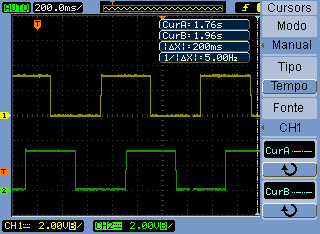

I did many things to test and I saw when I changed the "flag.change" to a variable "flagChange" declared as unsigned char I got this:
The above figure is the result I expect to have. It is okay I know it is working this way, but I'm not satisfied because there are many others flags in structs and I want they work properly. So I would like to understand what is happening.

ndavies
Contributor V
Are your interrupts at different priority levels?  If so, you may have one interrupt, interrupting the other interrupt.
The bit flag change ( flag.change =1) is a multiple operation command.  If the flag.change is interrupted by the other ISR in between those operations, it will corrupt the data.
The flagchange = 1 command is an atomic instruction. The higher priority interrupt can't modify flagchange in the middle of the lower priority interrupt
The interrupts either need to be at the same priority or you need to block the higher priority interrupt from running while the lower priority interrupt modifies the variable.

FredericoLuiz
Hello Norm,
Yes I have other. I'm using:
Systick Interrupt to create base time at 100us.
UART0 interrupt for sending and receiving data      -   Priority 0
TPM1 for pwm purposes -                                            Priority 4
PIT - Peripheral Interrupt Timer for multi tasks delay - Priority 4
ADC0 -                                                                          Priority 4
After reading your comment I made a test. I disabled all interrupts except FTM1. It worked ok!!! I added all other interrupts except UART0 and it worked as well. SO I think the 0 priority of UART0 is causing my headaches.
If I cannot atend for example a UART0 interrupt at, let suppose 9600kbps, is there a safe way to use priority 0 and flags in structs?
Many thanks!
