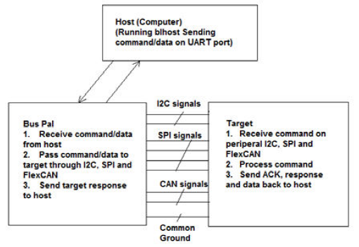

I am using two mcu in my project and need to upgrade firmware of both mcu via host application.
I am searching the feasibility and option to upgrade firmware of both mcu.
Below is the reference diagram :
Please suggest!

Jorge_Gonzalez
Hello Sunil,
- For the first case (upgrading MCU2), there is KBOOT solution. You can take the Flash resident bootloader to upgrade the MCU with commands from the PC.
- In the second case (upgrading MCU1) you need some kind of bridge firmware. Unfortunately we not have such implementation. Maybe the closest reference are the BusPal projects in the same KBOOT installation. The BusPal acts as an interface between the host PC with a UART connection and a different bus in the target MCU (I2C, SPI or CAN). See below:
You could take that project as reference (FSL_Kinetis_Bootloader_1_2_0\apps\bus_pal), but it may not be easy to adapt it to your requirements.
