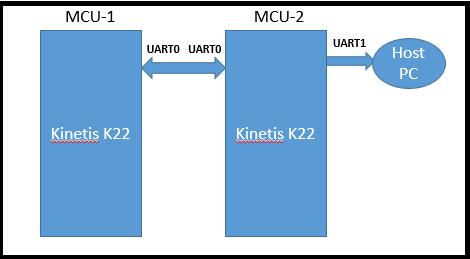

I am using two mcu in my project and need to upgrade firmware of both mcu via host application.
I am searching the feasibility and option to upgrade firmware of both mcu.
Below is the reference diagram :
Please suggest!
Sunil

Hello Sunil Singh:
Please tell us more about that configuration.
What is the intended application?
Will both MCUs have the same application firmware (clones) after the upgrade? Like some kind of programming chain.
What is the intended sequence for the upgrade (e.g. MCU-2 is programmed first followed by MCU-2 sending commands to MCU-1).

Hi Jorge,
Thanks for looking into this.
Both MCU  not having the same application.
Below will be the sequence to upgrade firmware.
1-) First Host will send command to  MCU2(KL26)  for upgrade firmware and upgrade it.
2-) Then Host will send another command via MCU2(KL26) to upgrade firmware for  MCU1(KL25) and it is not compulsory to upgrade every time but some time needed.
Its bit urgent for me and let me know if more inputs required.
Sunil

Hello Sunil,
- For the first case (upgrading MCU2), there is KBOOT solution. You can take the Flash resident bootloader to upgrade the MCU with commands from the PC.
- In the second case (upgrading MCU1) you need some kind of bridge firmware. Unfortunately we not have such implementation. Maybe the closest reference are the BusPal projects in the same KBOOT installation. The BusPal acts as an interface between the host PC with a UART connection and a different bus in the target MCU (I2C, SPI or CAN). See below:
You could take that project as reference (FSL_Kinetis_Bootloader_1_2_0\apps\bus_pal), but it may not be easy to adapt it to your requirements.
Regards!
