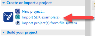

Ramon_Vega
Dear Rashmitha,
Thank you so much for your patience, please check this information below, I hope it be useful:

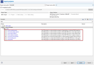

I truly recommend  download and install MCUXpresso IDE,
Once installed you can import examples about FTM in your IDE to debug and run it on your development board.

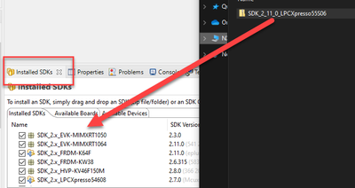

Download the following SDK:  Dashboard | MCUXpresso SDK Builder (nxp.com)
  • To install drag and drop the file in MCUXpresso installed SDKs section, please see the picture.

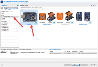

  • Create new project, please press this option.
  • Select the correct board then press next.
  • You will be able to find different kind of examples about FTM.

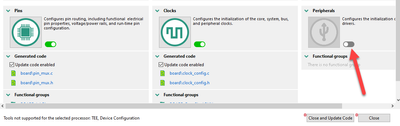

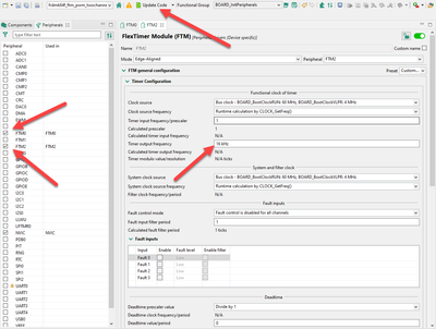

When you get at this point, you can enable FTM2 with your clock preferences, just follow the next steps:
  1. Please click in peripherals, it is right top in screen:
  1. Enable peripherals as in the picture if its needed then close.
  1. Left side please select the FTM you want to enable and choose clock frecuency, then press Update Code button, this will generate code to enable the FTM as you want.

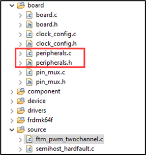

Last step is consult the generated code in the following files then you can use them in the main file called “ftm_pwm_twochannel.c”.
I hope this information be useful, please let me know for any other question.
Best Regards.
