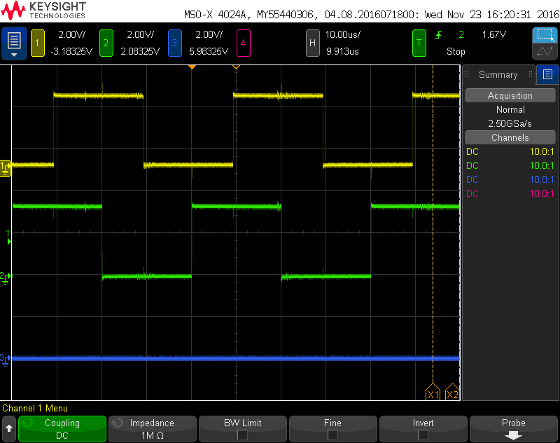

florianharmuth
Hello XiangJun,
thanks for your fast response. I have tried the exmaple in chapter 3.11.4 (Updating the FTM register with hardware control) which was the base for my previous tests. I have used the code from the application note with only one change - I have to use FTM0_FLT1 instead of FTM0_FLT0. I can't get the example running...I have also attached the a screenshot of the signals. The yellow one show the input signal of FTM0_FLT1 (GC0) and the green one show the signal of PTC1 - you can see that the rising edge of the yellow signal is ignored by the timer component. Any suggestions / ideas?
Florian

xiangjun_rong
Hi, Florian,
I suppose that you can NOT use FTM0_FLT1(PTC0) as hardware triggering signal. Pls refer to sectin 39.1.6 FTM Hardware Triggers in the reference manual of KV4x, only XBARA_OUT34 can be used as FTM0 hardware triggering source2. If you want to use external signal as FTM0 hardware triggering source2, you can connect the signal to any XB_INx pin and route the signal to XBARA_OUT34.
for example, you can connect the external triggering signal to PTC5/XBAR0_IN2
CLOCK_EnableClock(kCLOCK_PortC);
    PORT_SetPinMux(PORTC, 5u, kPORT_MuxAlt4);      //PTC5 as XBAR0_IN2/ALT4
XBARA_SEL17&=~(0x3F);
XBARA_SEL17|=0x02; //route the XBAR0_IN2 to XBARA_OUT34.
If you use the PWMA_0A triggering signal
XBARA_SEL17|=20; //route the PWMA0_TRG0 to XBARA_OUT34.
Hope it can help you
Xiangjun Rong

florianharmuth
Hello XiangJun,
thanks again for your fast response. After changing the trigger signal as explained the synchronization wasn't working (xbarin-xbarout34 and the direct soultion (pwma0_trig0 - xbarout34)). After reading the reference manual again and again I have found the comment "only the enhanced PWM synchronization must be used" - so my gues is that the legacy PWM mode shouldn't be used on this device right? I have changed the corresponding bit in the SYSCONF register and now its working. I have attached the working code - if someone else will have the same issue in the future....
Florian
