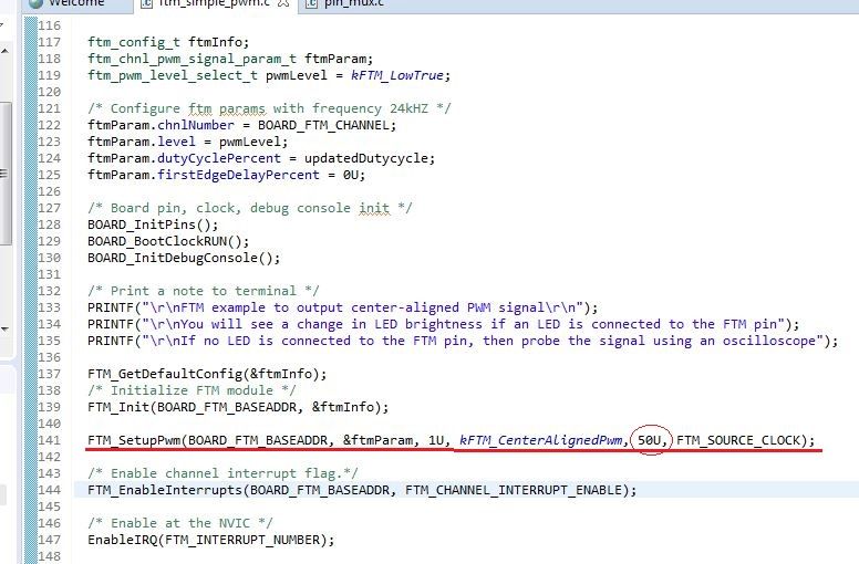

Hello
I'm using a K60 Tower to generate a PWM signal, i started by a default project from SDK (simple PWM) but when i try to generate a 50Hz Square wave the Tower can't get it i don't if someone can help me to understand why, below command line that i change to get this signal :Capture.JPG

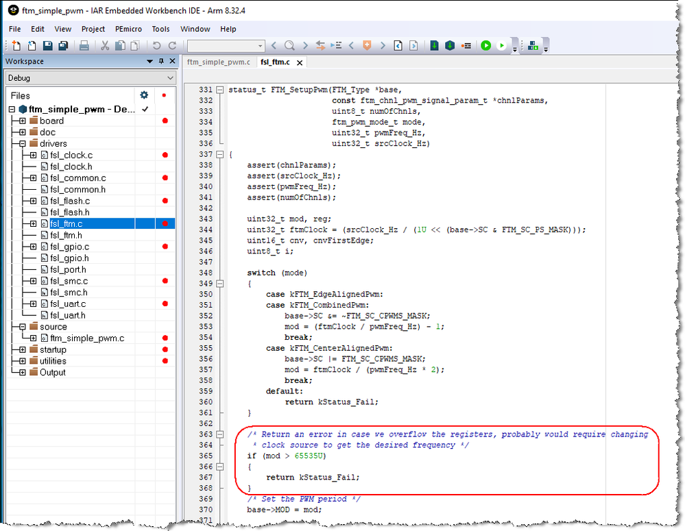

The ftm_simple_pwm example select Bus Clock(48MHz) as FTM_SOURCE_CLOCK.
The FTM_SetupPwm() will return error due to overflow the registers:

The API doesn't explain how to control things so you will need to study its code and work out how the pre-scaler needs to be set (I see that the pre-scaler value is read inside the call from the control register in order to calculate the value, meaning that the pre-scaler needs to be configured beforehand somehow).

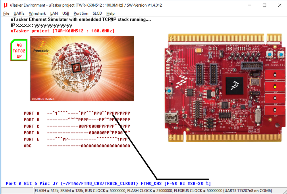

Below I used the uTasker project and K60 simulator to generate 50Hzz on PRC3 (FlexTimer 0 - channel 3), using 100MHz core, 50MHz bus clock and /16 pre-scaler, which gives exactly 50Hz output as (see simulation below):
    PWM_INTERRUPT_SETUP pwm_setup;
    pwm_setup.int_type = PWM_INTERRUPT;
    pwm_setup.int_handler = 0;
    pwm_setup.pwm_mode = (PWM_SYS_CLK | PWM_PRESCALER_16 | PWM_EDGE_ALIGNED); // clock PWM timer from the system clock with /16 pre-scaler
    pwm_setup.pwm_reference = (_TIMER_0 | 3);                            // timer module 0, channel 3
    pwm_setup.pwm_frequency = PWM_FREQUENCY(50, 16);                      // generate 50Hz on PWM output
    pwm_setup.pwm_value   = _PWM_PERCENT(20, pwm_setup.pwm_frequency);   // 20% PWM (high/low)
    fnConfigureInterrupt((void *)&pwm_setup);                            // enter configuration for PWM test

What frequency is FTM_SOURCE_CLOCK and what value have you set for the FTM pre-scaler?
If it is too high to be able to generate 50Hz using maximum divide of 64k (in MOD) the function will return an error and not generate an output:
1. Check return value for errors
2. See the source code of FTM_SetupPwm() to see what it does and what causes it to fail
