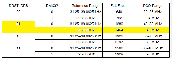

The function BOARD_InitOsc0 is only configuring the system oscillator. OSC frequency, MCG range, enable capacitor. You have an external OSC and the frequency is 32.768 KHz.

As you can see the mcg configuration is working in FEE mode, and selecting the OSCCLK. If you want  to know or to modify the frequency, you should modified the values of drs and dmx.
The select values are drs = 1 (kMcgDcoRangeSelMid ) and dmx32 = 1 (kMcgDmx32Fine) and with this you have a frequency of 48MHz. The core is working with 48MHz.
DCO RANGE = 1464 * 32.768KHz =  47.972352 Mhz.
