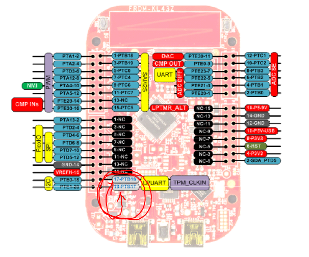

I'm trying to use the LPUART on the FRDM KL43z, I've configured the MUX on PTB16 and PTB17 to ALT3, which should make PTB16 the RX and PTB17 the TX. However, PTB16 is the TX when I transmit, am I missing something? or is there a piece of documentation wrong somewhere (Either in the listings for PTB16 and PTB17 in the Schematic and Quick-Start guide for the board, or the MUX information in the reference manual for the KL43)?
2,513 Views
mjbcswitzerland
Specialist V
The Quick Start Document is wrong:
Pin 17 should be PTB17 and Pin 19 should be PTB16.
Basically, never trust these documents (there are quite often some details that somone has typed in incorrectly) but instead work with the actual circuit diagram of the board to avoid any surprises. If you prefer working with the pretty Arduino styles this is OK but only do so after verifying that they are indeed a true reflection of the real hardware!!
Mark
Mark

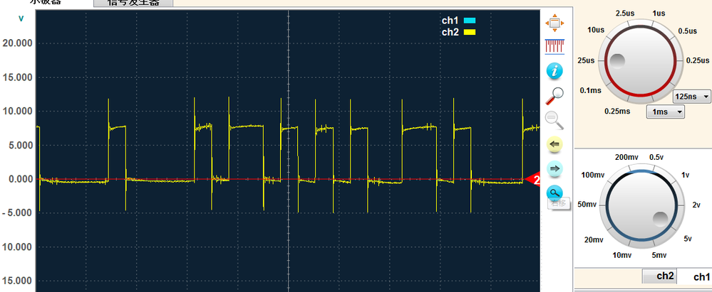

danielclark
Hi Alice,
When I set my code to continuously transmit 0x00 then 0xFF, I can put a scope on PTB16 and see it there, but not see it on PTB17.

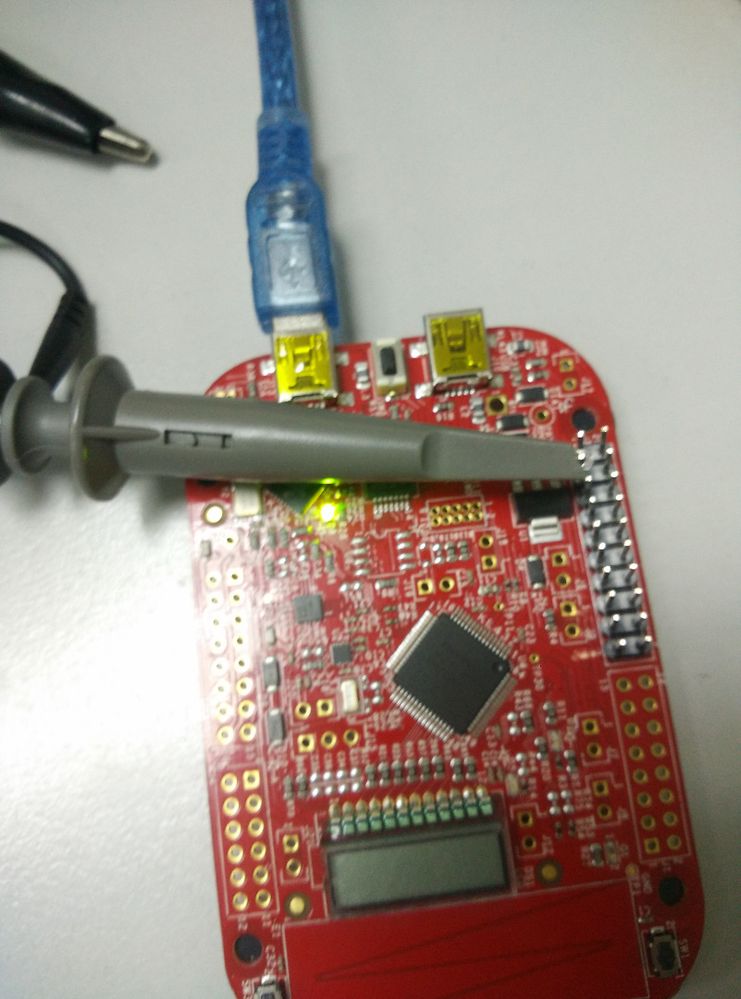

Hello Daniel,
I have test it my board, when use the UART0 , PTB16 as RX, PTB17(J2-17 board) as TX,
when send , the PTB17 have signal .
I also attach the project i test , it is a KSDK1.3 project. If you have install KSDK1.3, you can
test it on your side .
Hope it helps you !
Alice Yang

You've said PTB17 is on J2-17, but this documentation: http://cache.nxp.com/files/microcontrollers/doc/user_guide/FRDM-KL43Z_QSG.pdf
and the "Quick Reference Card" I got with my board, says that PTB17 is on J2-19, and PTB16 is J2-17.
According to those documents, the port you've got your probe on is PTB16.

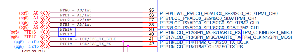

Hello Daniel,
There are not only one version of the FRDM-KL43 board , there have Rev A , Rev B,
Rev C and so on, the quick start have not mentioned this board version .
So please check the SCH of your board , my FRDM-KL43 is Rev C, on the related SCH:
Also please check yours.
Hope  it helps
Alice

Hello Dainel,
Yes, when configure the PTB16 and PTB17 to  ALT3, the PTB16 is LPUART0_RX,
the PTB17 is LPUARTO_TX.
Also from the SCH of FRDM-KL43,we can see :
So how do you think PTB16 is the TX when you transmit ? Form where ?
