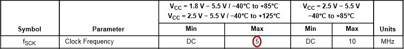

I have interfaced CAT25256 EEPROM over SPI. Can you please tell me what is the minimum SPI clock frequency require to communicate with this EEPROM?

The datasheet says that the clock frequency goes form 0 to 5 MHz.
When you make an EEPROM write does the other signals work fine? Is only the SCK signal missed?
Earl.
