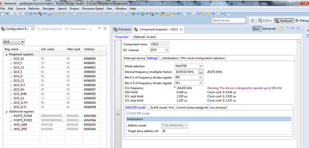

Thank, but still do not working. I Also set IICE bit in C1 register, without any results. Futher part of configuration register:
Maybe the problem is that i using PTA1 and PTA2 pins on OpenSDA virtual COM connection. But i dont think so because this is another I / O port than PTE24 and PTA24 in which and using i2c interface. Or maybe other I2C settings:

Jorge_Gonzalez
The project has processor expert support. Why are writing to registers directly instead of using Processor Expert APIs?
You can use the provided methods (SendBlock, ReceiveBlock) to create your application. Also, do not enable interrupts if you plan to use polling method. Or the other way, enable the interrupts but do not poll the I2C flags, instead fill the interrupt service routine with the required code.
