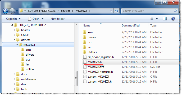

I'm using the FRDM-KL03Z evaluation board with kds. Where can I find the TPM_BWR_xxx definitions? I don't want to use the predefined functions to control the timers, I want to write to the registers directly. Are there any good references around for this microcontroller?
Thanks!

Maybe you can use the MKL03Z4.h in SDK_2.0_FRDM-KL03Z.
Robin

Hi Robin,
Thanks for pointing me in the right direction. I now have another question! When I look through the definitions in that file, I see that there are read (RD) and write (WR) operations as well as BRD and BWR. What does the “B” mean? When should I use the RD versus the BRD and same for the WR and BWR?
