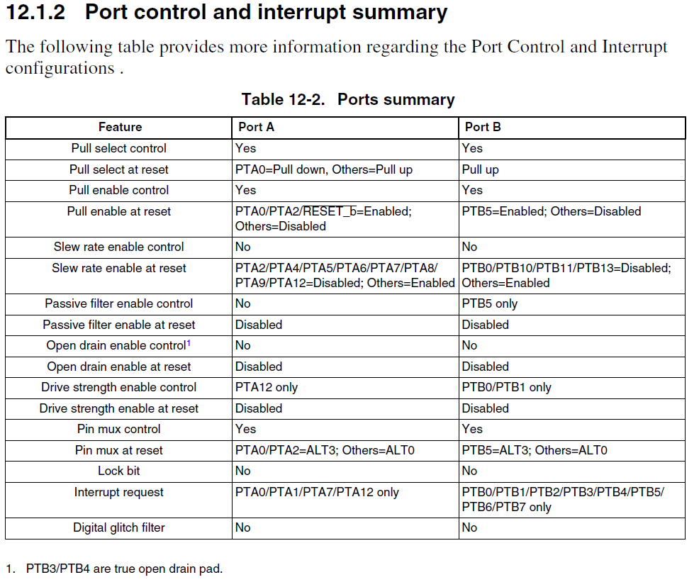

This is my representation of the GPIO and PORT interaction:
The interesting part is that if the GPIO function is not selected (eg. the UART is connected to the pin in the PCR MUX setting) the PDIR register still reflects the pin's state, which suggests that the PDIR is always connected to the pin, so reading the state is always possible.
When the PORT doesn't select GPIO mode it is not possible to control the pins state as an output (this is obvious).
The PORT module controls also pin interrupts and DMA (not your KL03 but most other devices), which can operate irrespective of the pin's multiplex function.
Always read the GPIO instantiation description for deviations and reset defaults:
