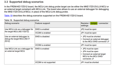

First, please pay attention to your jumper switch. You can find the relevant information about it at FRDM-KE17Z512 Board User Manual.

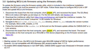

Secondly, if there is no problem with the jumpers, please try to flash or update the firmware of the mcu-link. The details are as follows:

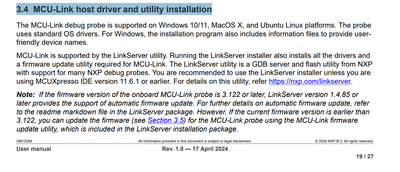

However, for boards with the LPC55s69 as the on-board debugger (we call it mcu-link), for the introduction of the mcu-link, you can refer to section "3 MCU-Link OB debug probe" of FRDM-KE17Z512 Board User Manual. For the firmware upgrade, you can refer to section "3.4 MCU-Link host driver and utility installation" and section "3.5 Updating MCU-Link firmware using the firmware utility" of it.
After the above two attempts, you should be able to use external debuggers, such as JLink, normally.
