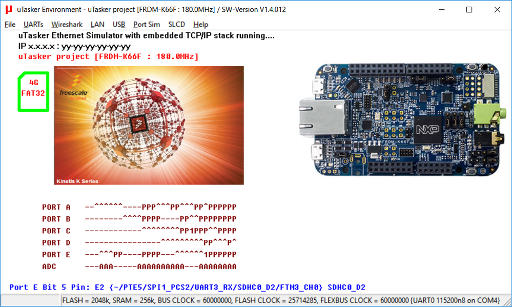

Is it so that 12MHz excludes use of the PLL as an 180MHz MCU clock? 16MHz would do it it seems.
2,569 Views
mjbcswitzerland
Specialist V
12MHz crystal can be used for 180MHz operation (in HSRUN mode).
http://www.utasker.com/kinetis/MCG.html
See below (simulation of K66 board) with the following settings:
#define CRYSTAL_FREQUENCY    12000000                    // 12 MHz crystal
#define CLOCK_DIV            1                           // input must be divided to 8MHz..16MHz range (/1 to /8)
#define CLOCK_MUL        30                              // the PLL multiplication factor to achieve operating frequency of 180MHz (x16 to x47 possible) [PLL output range 90..180MHz - VCO is PLL * 2]
#define BUS_CLOCK_DIVIDE     3                           // 180/3 to give 60MHz (max. 60MHz)
#define FLEX_CLOCK_DIVIDE    3                           // 180/3 to give 60MHz (max. 60MHz)
#define FLASH_CLOCK_DIVIDE   7                           // 180/7 to give 25.714MHz (max. 28MHz)
Beware of restrictions in HSRUN mode - for example flash programming is not possible.
