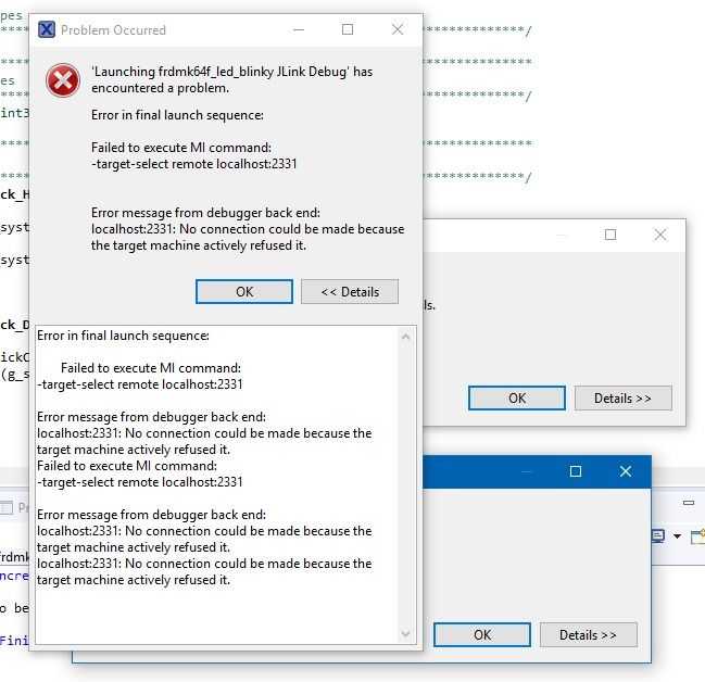

Hello, good day.
I was doing some test with a simple code to turn the LEDs on in a certain color sequence (I had tested the code before and it worked fine). But, suddenly the K&4disconnected  and it kind of "blocked" itself, now I am unable to load any code into the K64. I get the following error:
Error 1.jfif
I tried to check the K64 with J-Link Commander and also I an error, it is the following one:
Error 2.jfif
Also, I noticed that the K64 starts to warm up when I try to load code.
Can you please help with this? I don't really know why this started to happen.
That is indicating to me that you have a hardware failure and the K64 is damaged (ESD maybe?).
Is this your custom board or the FRDM-K64F?
I'm affraid that you would have to change/replace the MCU/Board.

Oh dear, well, thanks a lot for the quick response. Do you know if there is some warranty that I can use? I bought the K64 about 2 months ago.
