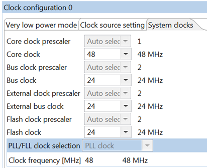

The CPU core clock was set to 48 Mhz, as can show in figure below.

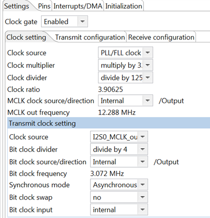

It was used a sample rate in 48 KHz. For this the MCLK must be 12.288 Mhz, and BCLK in 3.072 MHz.
This configuration was set in I2S_Init component as can be seen in figure below.

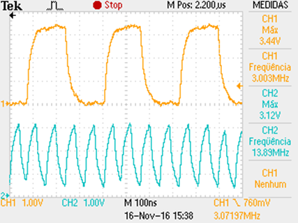

However, the codec was not emitting sound. So I decided see in oscilloscope the I2S pins. The figure below is a oscilloscope print from pins PTA5 (BCLK), in CH1, and PTC8 (MCLK), in CH2.
The clocks are distorted. The componentes was correctly soldered and based on xls document downloaded from here:

xiangjun_rong
For the bad waveform of MCLK and Bit clock of I2S, I do not think it is I2S module issue. Maybe your oscillosope bandwidth is limited, or you use float wire to connect the clock signal, which have parasitic capacitors.
Hope it can help you.
