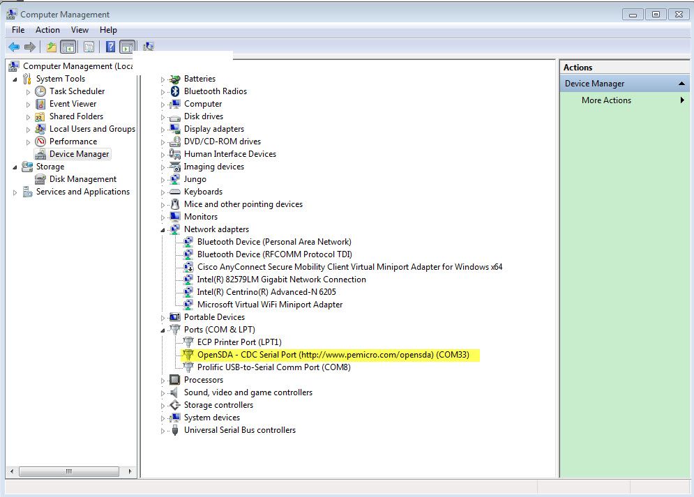

  1. check your COM in your computer management:
  This picture is from my side, my com is COM33, this step is very important!!!

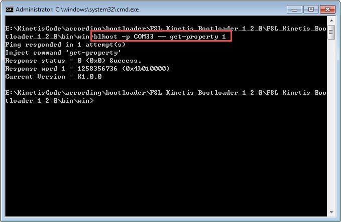

2. Open a command prompt in the directory containing blhost. For Windows OS, it is <install_dir>/bin/win.
3. Ping the COM port in blhost
If you get the current version, you will pin the COM successfully.

Dear Jingjing Zhou,
as I have said the PEMicro drivers are present of my PC, because previously with OpenSDA bootloader everything has worked correctly.
My COM port is 13, and the only way to check this is by loading the OpenSDA bootloader on the board.
With FRDM_KL43Z4.bin from FSL_Kinetis_Bootloader_1_2_0\apps\binaries (KBOOT) the port does not show up.
After going to blhost directory and typing the command I get a following error (operating on OpenSDA):
Error: Initial ping failure: No response received for ping command.
What am I doing wrong?
