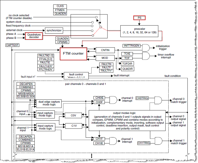

I am trying to use demo application to do encoder(PhA and PhB) on FTM1 and FTM2 of KV58F.
I found the counting is related to "ftmInfo.prescale = kFTM_Prescale_Divide_32;//kFTM_Prescale_Divide_32;"
If I use kFTM_Prescale_Divide_1, I got much more counting. Why? It should not be related to FTM clock, right?

I set INIT=0, MOD=65535 in sample project.
If I select pre_scale=1, the counts I get are 32 times of pre-scale=32.
Can anybody tell me why? My understanding is that the counts should be the same?

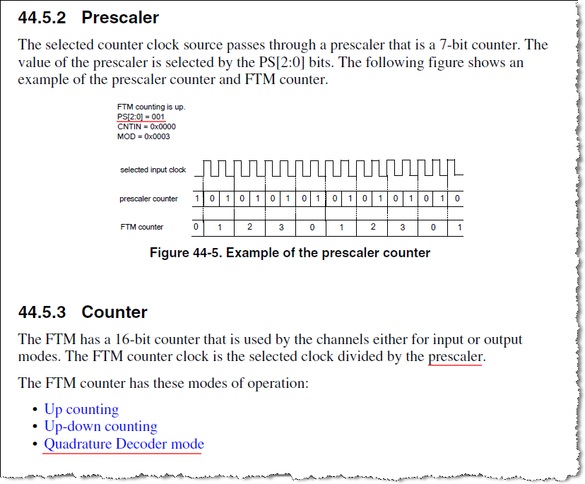

Robin_Shen
Hi Christie,
Please refer the 'Figure 44-3. FTM block diagram' in KV5XP144M240RM.
The FTM counter clock is the selected clock divided by the prescaler.
Robin
