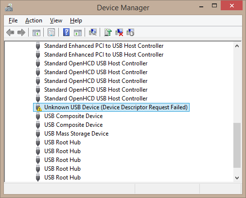

Good Afternoon:
I am trying to configure the virtual com port application with the Beestack and the KW24 Processor with no results.
I initialize these modules in the BeeAppInit.c file:
USB_Init();
  (void)CDC_ModuleInit();
and define the variable:
#ifndef gVirtualCOMPort_d
  #define gVirtualCOMPort_d    TRUE
#endif
in CDC_Interface.h file
then I try to send a string to the virtual com with the function:
bool_t CDC_Transmit(unsigned char const *pBuf, index_t bufLen, void (*pfCallBack)(unsigned char const *pBuf))
the application runs, but when I connect the device to the computer the system doesn't recognize it, and I get this error from device manager:
How could I solve this problem?
or there are an example with USB-CDC in BeeStack?
I'm working with BeeKit and IAR Embedded Workbench
Thanks!

alejandrovelez
Hi Isaac,
Yes, I solved it, it seems that the problem was my board,
thank you
BR.

fabricetocci
Hi Alejandro,
I had same problem and succeeded to resolve.
You need to install Windows driver for Freescale Kinetis product.
You can find the cdc.inf file enclosed in the followinf thread.
Kinetis USB CDC driver supported on Windows8, Windows10

alejandrovelez
Hi Fabrice
Thanks for the help, it seems that my board was the problem too, I change it and it works
