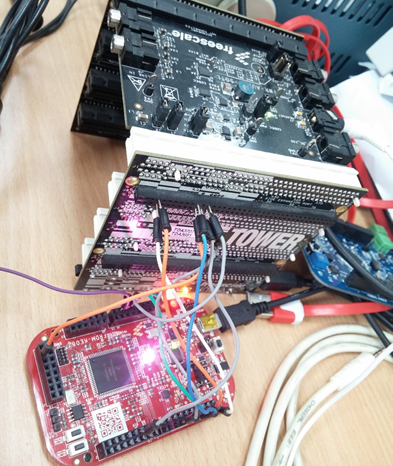

HW/SW Requirement
Hardware
  • FRDM-KE06Z (RevA)
  • TWR-AUDIO-SGTL (RevF)
Software
  • IAR 7.40.x
  • Demo source code package (include KE06 driver lib)
Hardware Configuration
Connections between two boards
Pin function
FRDM-KE06Z
TWR-AUDIO-SGTL
I2C SDA
PTA2 (J2-18)
ELEV_I2C0_SDA (PRIMARY A8)
I2C SCL
PTA3 (J2-20)
ELEV_I2C0_SCL (PRIMARY A7)
I2S BCLK
PTB2 (J2-12)
ELEV_I2S0_SCLK (PRIMARY A22)
I2S TX FS
PTC5 (J1-11)
ELEV_I2S0_LRCLK (PRIMARY A23)
I2S TXD
PTB3 (J2-8)
ELEV_I2S0_DIN (PRIMARY A25)
GND
GND (J2-14)
GND (PRIMARY A26)
FRDM-KE06Z

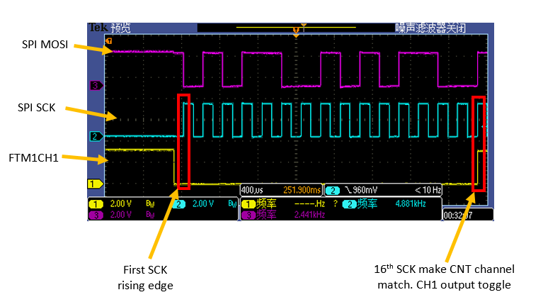

To generate Frame Sync signal for I2S by using FTM, the SPI SCK (BCLK) must be used as FTM clock source, connected to TCLK1:
PTB2 (J2-12) <-> PTE0 (J4-1)
TWR-AUDIO-SGTL
Power from the ELEVATOR 5V: J5 set.
MCLK is in from onboard 24.576MHz crystal: J6 unset.
Headphone is inserted to J7.

FTM
  • FTM1 as EPWM mode, clock source is external from SPI0 SCK
  • FTM1 C1V=16, MOD=31
  • FTM1 CH1 output as I2S TX_FS – 12KHz

To use the SPI SCK as external clock source for FTM EPWM counter, there is a limitation: the FTM counter is increased on the rising edge of external clock, so the channel match and overflow event (FTM1CH1 output toggle) would happen on the rising edge of the external clock. Due to this, the data on the SPI MOSI must be valid on the SCK falling edge to make sure the data would not be fetched on the edge of frame sync. This causes the first left channel frame sync (TX_FS) would be one BCLK ahead of I2S data. This first left channel only contains 15bits valid data, see below figure:
A software workaround must be made to drop the 8th bit in the first 8bit data, to make sure all of the other data left and TX_FS is synced.
        SPI_WriteDataReg(SPI0, (music[0] << 1) | ((music[1] >> 7) & 0x01));

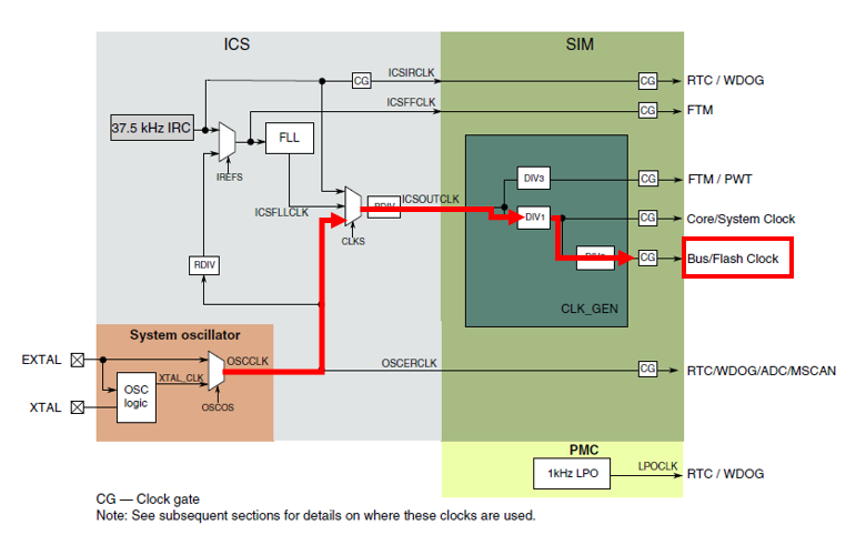

The general I2S frame rate is 12K/32K/44.1K/48K/96K, bit length is 16/24/32. So the BCLK frequency is frame_rate x 16, 24 or 32. For I2S clocking, a 32.768 KHz, 12.288 MHz or 24.576 MHz clock is recommend to generate the BCLK/FSCLK.
You cannot get a very accuracy BCLK from SPI SCK by using the internal IRC or connected a normal external crystal like 8MHz, 12MHz. The SPI clock source is from BUS_CLK, and no fractional divider supported. So to get an accuracy sample rate, a 12.288MHz, 24.576MHz is recommend to connect to EXTAL/XTAL for the BCLK/FSCLK generation. The FLL bypassed external (FBE) clock mode is selected with FLL disabled.

  • Also configure the system/core/bus clock from external OSC, but not IRC.
