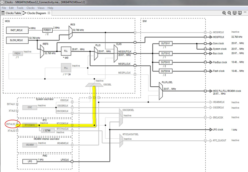

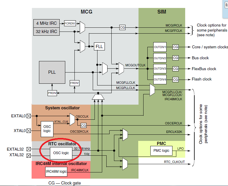

xiangjun_rong
Hi, Vincent,
I see that you want to connect the 12MHz crystal to the Extal/Xtal pins, connect the 32.768kHz CLKOUT pin  of the PCF2123 to the Extal32 pin of K64F so that you can save a 32.768KHz crystal, but the solution is infeasible. It is okay to connect 12MHz crystal to Extal/Xtal pins. But Extal32/Xtal32 pins can only interface with crystal, it can not interface with clock source, so it is not feasible to interface the 32.768KHz clock source from PCF2123 to Extal32 pin.
Hope it can help you
Xiangjun Rong

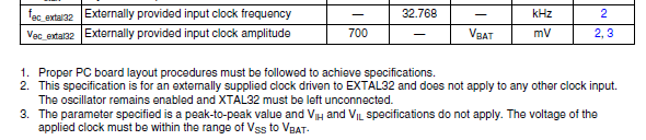

egoodii
Senior Contributor III
The K64 datasheet supplies this option for driving EXTAL32:
I presume this means 'AC coupled'?  I'm not quite sure how you would get this drive-level from your open-drain output in a 'very low power' way...
